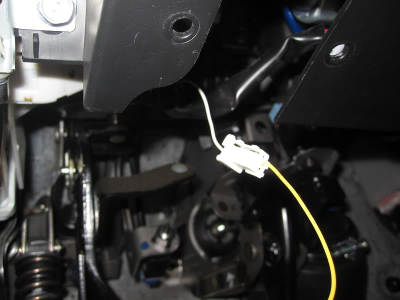

Step 2: Locate the TPMS interface plug. This is a white female plug that is attached to the OBD II wire loom under the dash right about where your left knee would be when sitting in the driver's seat. You may have to cut the tape that is holding the TPMS interface plug to the OBD II wire loom.
Attachment 171589
Step 3: Attach a paper clip or wire into the interface plug.

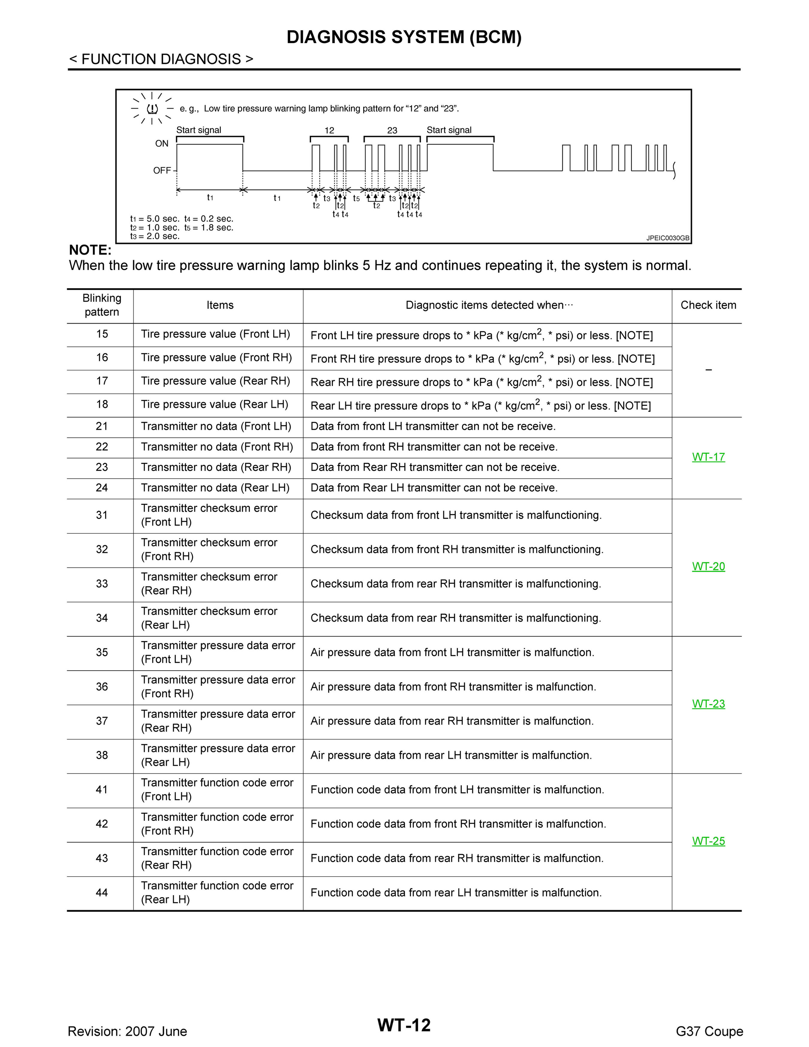

If you are having problems with the above procedures:
If the instructions did not work for you, there might be a problem with one of your sensors. To find out, you need to enter the diagnostic mode.
To do that, first turn the car to the on position and ground terminal of the tire pressure warning check connector. The malfunction location is indicated by the low tire pressure warning lamp blinking.
Refer to the following chart to find out the problem:
Attachment 171590
After you are done reading the code, you can turn off the car while the connector is still grounded. This will clear the stored codes. Then repeat the steps in the top of the page.
