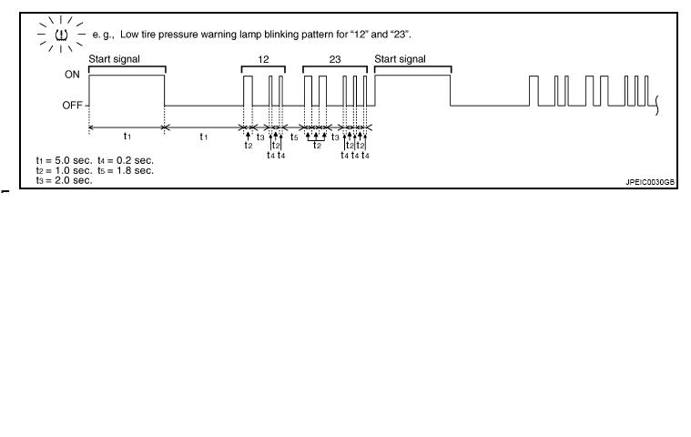

If the instructions did not work for you, there might be a problem with one of your sensors. To find out, you need to enter the diagnostic mode.
To do that, first turn the car to the on position and ground terminal of the tire pressure warning check connector. The malfunction location is indicated by the low tire pressure warning lamp blinking.
Refer to the following chart to find out the problem:
After you are done reading the code, you can turn off the car while the connector is still grounded. This will clear the stored codes. Then repeat the steps in the top of the page.

It could be. While setting up my car computer, I let the car idle for a long time. The TPMS light came on after a while. The pressure sensors do not send signal to the BCM when the tires do not spin. After not getting a signal for a long time, the BCM triggers the light, thinking the sensors are no longer present. Maybe this happened to you too?
In any case, try the reset procedure. If you just ground the TPMS pin, it will flash diagnostic codes. Depending on the number of flashes, it will report what malfunction is detected in the system.
