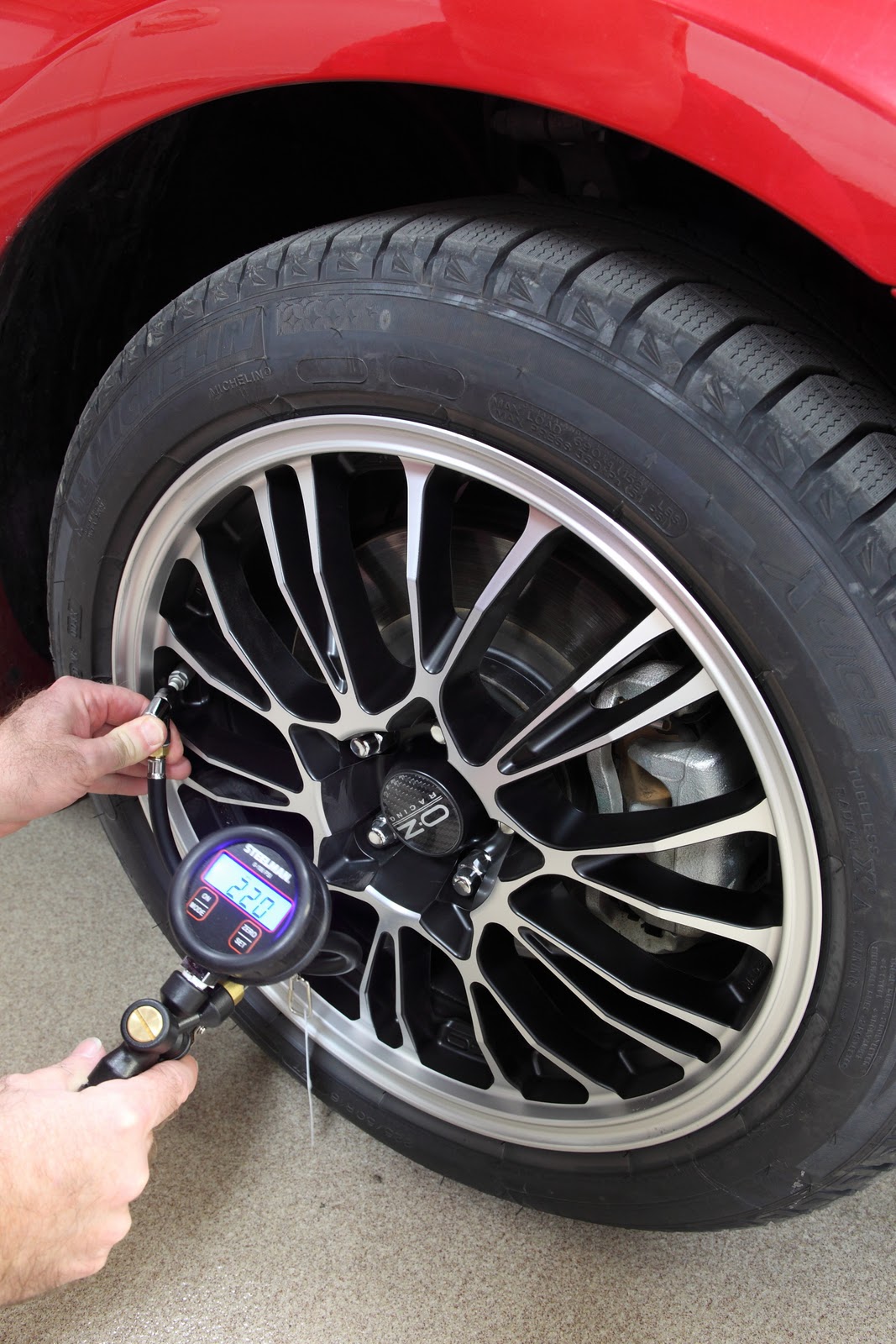

It worked for me the first time I tried it on my wife's 2009 G37xS, on which I just installed winter wheels/tires (O.Z. Racing Botticelli wheels with Michelin X-Ice Xi2 winter tires).
FWIW, on this car, the wire to the TPMS connector on this car was white, not yellow. And the procedure worked with the engine already started for me. So these are the instructions I'm keeping (including more precise tire pressure information for some of the units):
  1. Set the tires to the following pressures, they have to be exact: <TABLE><TBODY><TR><TH>Tire position </TH><TH>kPa </TH><TH>bar </TH><TH>kg/cm<SUP>2</SUP> </TH><TH>PSI </TH></TR><TR><TD>front left </TD><TD>240 </TD><TD>2.40 </TD><TD>2.45 </TD><TD>34.8 </TD></TR><TR><TD>front right </TD><TD >220 </TD><TD>2.20 </TD><TD>2.24 </TD><TD>31.9 </TD></TR><TR><TD>rear right </TD><TD>200 </TD><TD>2.00 </TD><TD>2.04 </TD><TD>29.0 </TD></TR><TR><TD>rear left </TD><TD>180 </TD><TD>1.80 </TD><TD>1.84 </TD><TD>26.1 </TD></TR></TBODY></TABLE>
  2. Locate the TPMS interface socket. This is a white female connector that is attached to a white (or yellow) wire attached to the OBD II wire loom under the dash right about where your left knee would be when sitting in the driver's seat. You may have to cut the tape that is holding the TPMS interface socket to the OBD II wire loom.
  3. Attach a paper clip or wire into the interface plug.
  4. Start the engine.
  5. Tap the end of the paper clip or wire on any exposed ground (metal) 5 times within 10 seconds.
  6. If you completed the previous step correctly then the TPMS warning light will start to flash slowly: you have activated the TPMS relearn process. If it flashes fast, that's not right. If yours isn't flashing slowly, then check your connections, turn the ignition off and start over at step 4.
  7. Once you confirm the lights do not stop flashing (wait more than a minute; two minutes is good), start driving at at least 25 MPH until the light goes out. It could take as long as ten minutes.
  8. Inflate tires to 230 kPa (33.4 PSI) so the light doesn't come on to indicate that some of your tires are low. You might be able to drive 6 miles or more before light will come back on due to low tire pressure. If the light does come back on due to low tire pressures, go ahead and reinflate them and the light will probably turn off later once the tire pressures are acceptable.

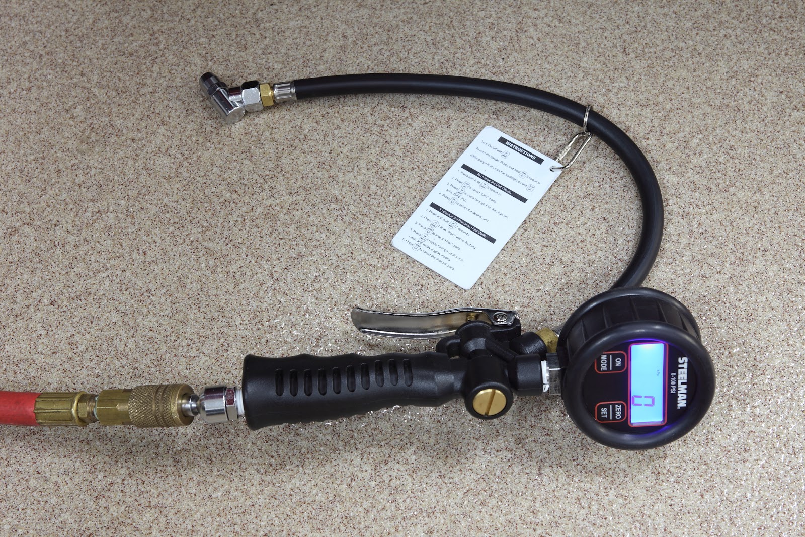

One other thing... I'll take this opportunity to recommend a really great digital tire inflator that I picked up a few weeks ago: the Steelman 97977. ToolTopia carries it for $144.99. Lots of money for an inflator, but this unit is really nice. In particular, it's really quick achieving an exact target pressure: squeeze the lever about halfway to release air or squeeze all the way to add air. Release lever to take a pressure reading. Amazingly quick to get exactly the pressure you want. Settable to all the common pressure units (I usually use kPa).
