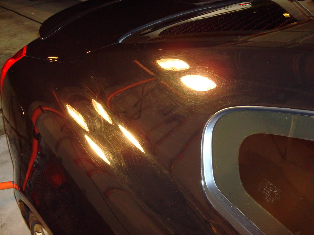

What are swirls marks exactly? I know they are caused my improver washing and drying but they seem to be too perfect of circles to be caused by the motion of my hand. How deep r they in the clear coat?
Old Mar 13, 2009 | 12:27 PM
  #702
Black Betty's Avatar
Lexus Defector
iTrader: (60)
Posts: 21,148
Likes: 2,093
Old Mar 13, 2009 | 12:55 PM
  #703
Detailed Image's Avatar
Detailed Image
Auto Detailing Expert
Joined: Mar 2007
Posts: 4,461
Likes: 69
From: Albany, NY
Black Betty posted up a great picture of swirl marks in the paint. Swirls can come in various forms and depths. Washing and drying swirls are usually on the surface and are revealed during certain lighting, like sunlight. Deeper imperfections, like what BB posted, usually require a halogen (or equivalent) light source to reveal. If you have marks like BB posted, chances are you're going to need a quality buffer to effectively remove most of them.
If you have any other questions please do not hesitate to ask.
Thanks Jeremy for posting up the pics.
George

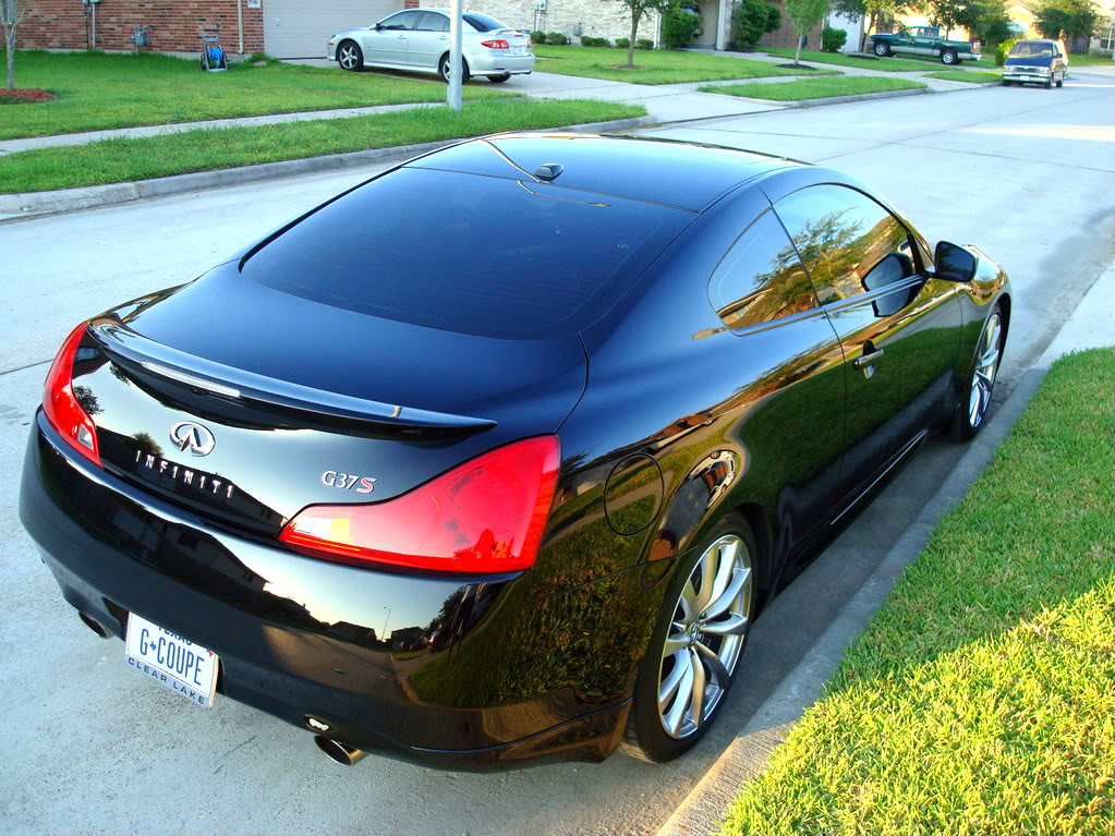

In fairness to Betty, she asked me to post the "after" photo from that detail:
Can't wait to get the Flex in to get even more correction for the stuff that the PC just couldn't quite make perfect.
