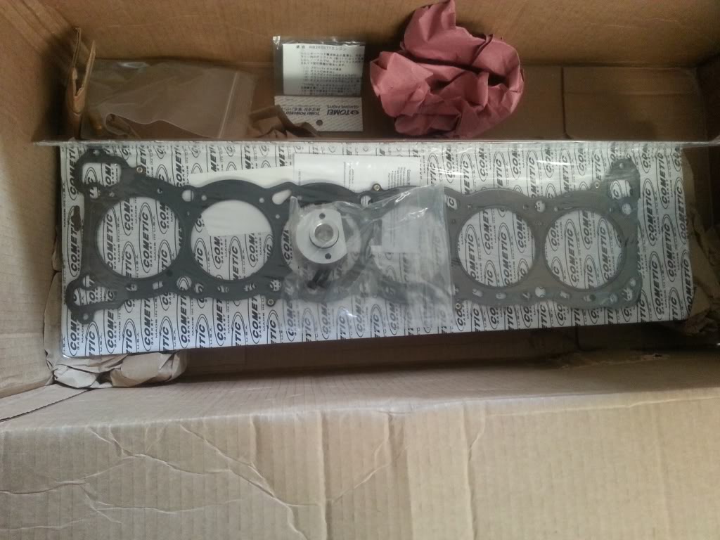

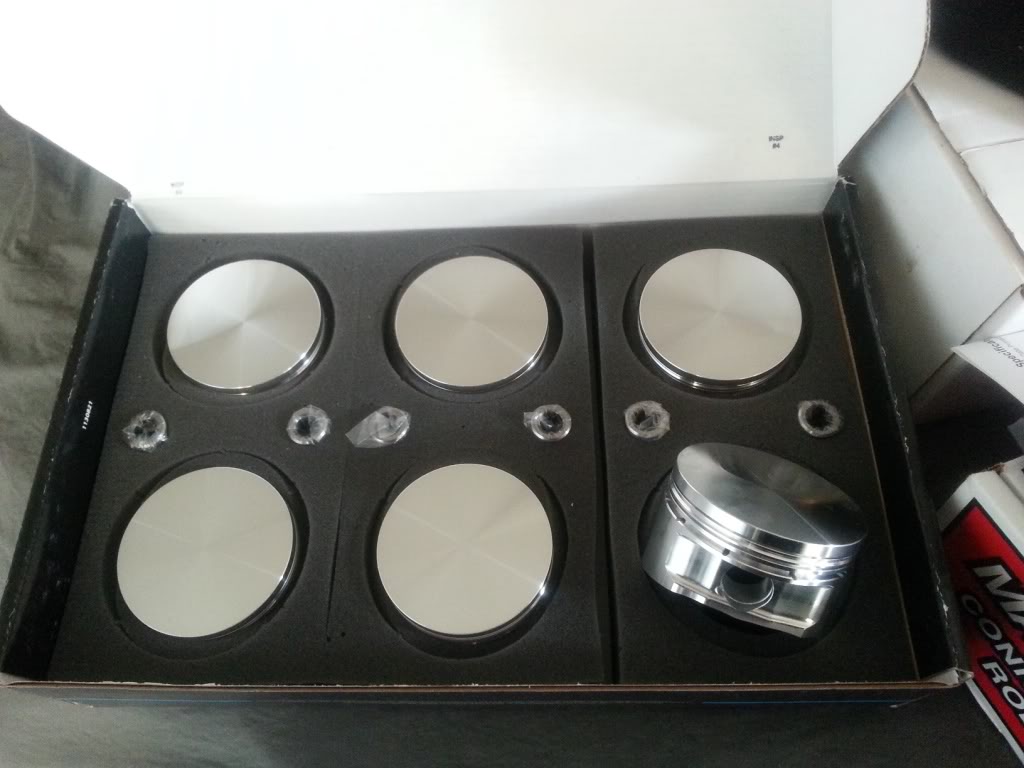

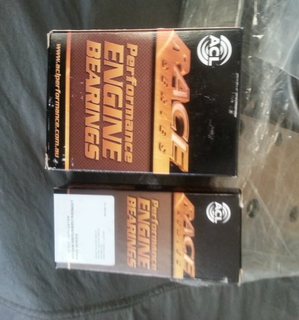

Aaaaaand we're back on track!

PS: You should have gotten Wiseco HD or Ross pistons, they are proven to be the strongest type of pistons with the strongest wristpin design, the wristpins that came with your pistons are way too hollow and could be a major weakpoint in your build if you start making power,
Below is an example of what i mean, this isnt a direct comparison but you get the idea. What im talking about is on the left, what you have is on the right.
Let's see how these suckers hold up for now, I'm not shooting for 1000hp (yet ) so these should be fine. The next time we open up the engine I'm stroking that biatch!
Thanks a lot for your informative post

Good luck with the new build just make sure everything is within spec, make sure machinist checks clearances for the new bearings, sometimes you might need to mix oversized and standard size bearings to accommodate equal clearances for all the rods/main bearings...and also measure the bore on the new block and make sure it complies with clearance specs for the pistons because forged pistons have different expansion rates than cast or different types of forged material pistons. better to be safe than sorry.

The pistons I got are 0.5mm oversize (86.5mm) and all the bearings are 0.25mm oversize too. This way, everything can be machined to fit easily
