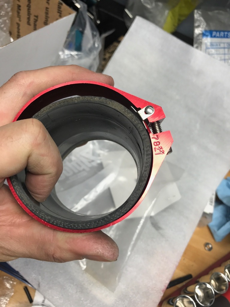

LOL, you guys are tripping over one another with the same problem.
I'm using a HPS coupler at the TB. Specifically a 4" x 70mm coupler that I cut in half, one for each side.
Here's an old pic. Does mine look thicker than yours? Do you get that question a lot?

Here's mine. Let's compare.

Mine is thinner and is super soft. (what am I walking into here...)

Mine's pretty soft too, but that could just be due to the age of it. LOL

The EXACT issue I was having. Got some of the smaller size clamps to see if I could make them work, but not enough thread catching inside the clamp. Just ordered some HPS couplers to beef things up.
Yeah, Andy, that's what I'm worried about with the smaller clamps... that I won't be able to catch enough of the threads to get a nice tight and secure connection. Plus, my couplers are molded reducers (2-3/4" down to 2-1/2"
) from GTM, so I can't just swap them out for another type.

just got slightly longer metric allen bolts.... Yay speciality hardware stores lol. Problem solved temporarily while I wait for the fat John pipes, I mean HPS couplers.
