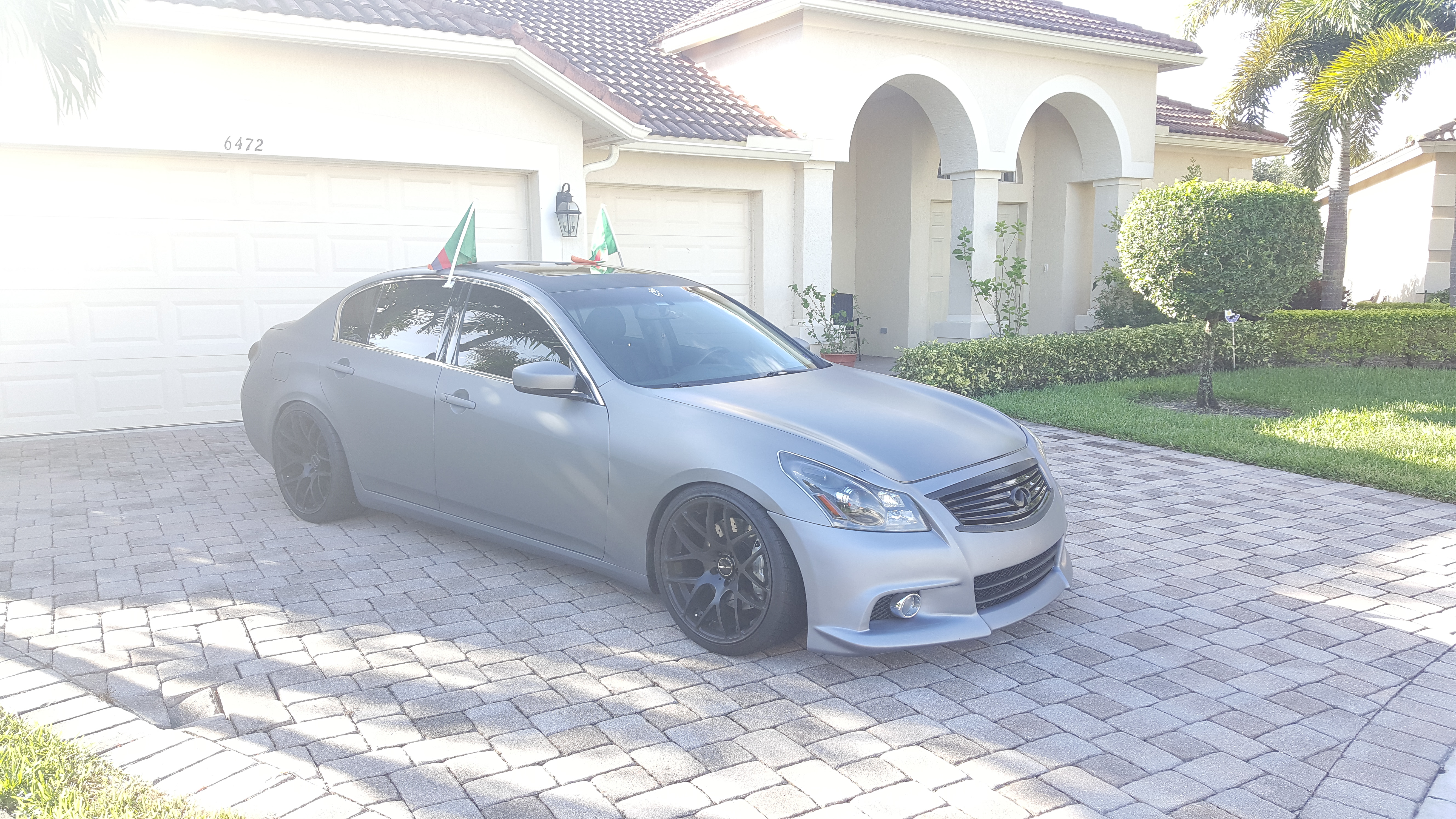

Im running the same wheels. but im 20x10 +20 all around...
i went with this style wheel cause it cleared the bbk. i did however pull and roll my fenders. but then again i am running 275/35 all around
your car is amazing! I wish I could run the same setup, but I'm not fond of running 20's or modifications. So, if I had decided to run 20's, would a more narrow tire/wheel eliminate the need for mods to the fender?
