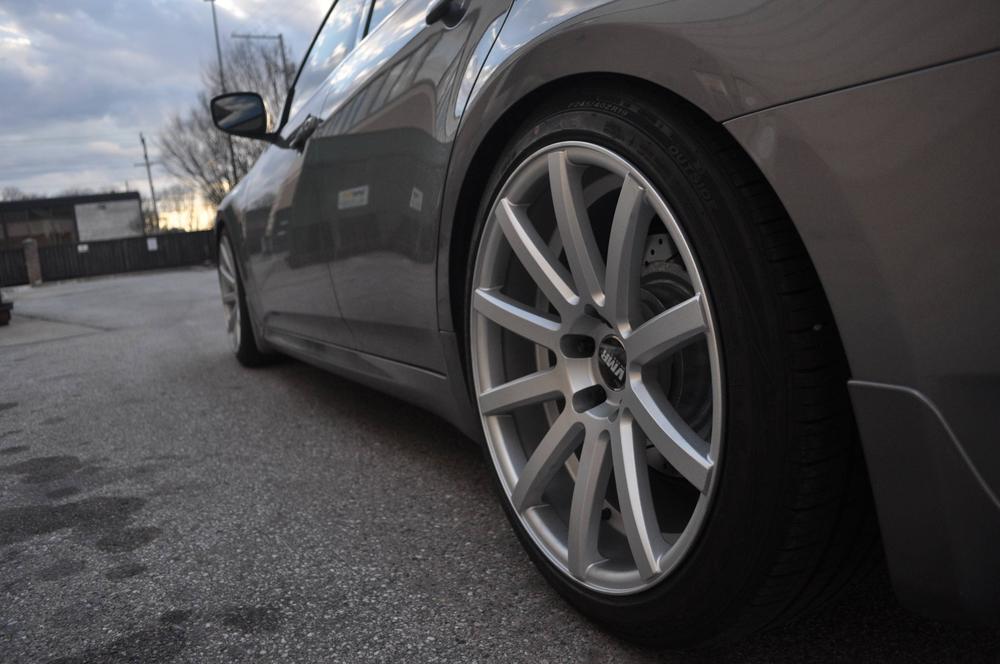

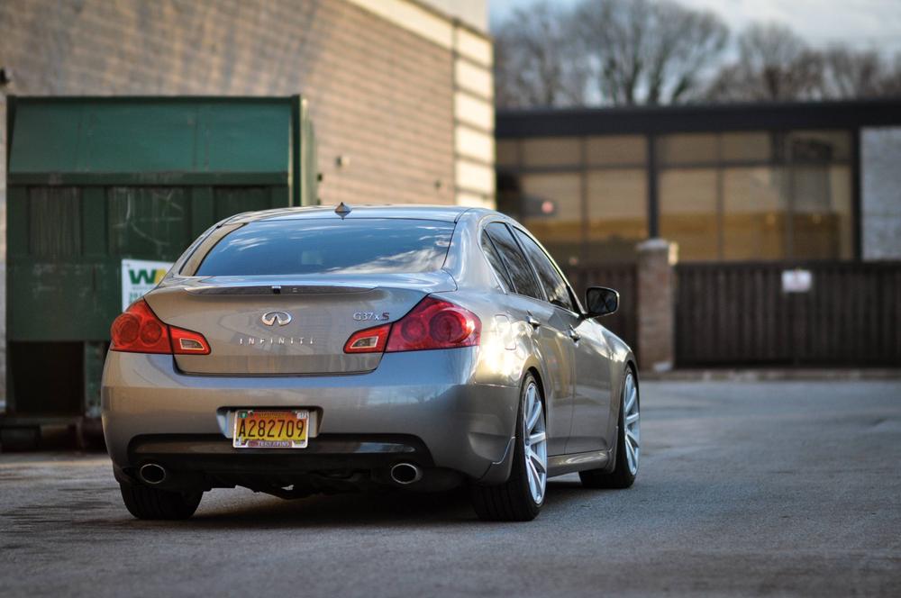

New setup! 19x9.5 +33 with 245/40/19 on all corners. Absolutely no rubbing!

You mean new "sexy-as-hell" setup Mr. 93!
Thanks! Fitment is perfect. I do have a little more wiggle room if I wanted to add a 5mm spacer or so, but I don't want to push the envelope. I enjoy not rubbing
This looks great! I've been a fan of those V702s a while now, those and the V706s. Good choice again man, looks sweet.
Old Mar 21, 2016 | 04:30 PM
  #435
Strokelessone's Avatar
Strokelessone
Joined: Nov 2015
Posts: 69
How much of a drop are you running, and are you able to keep camber within spec without additional parts/camber kits? I appreciate any info you can give me, really like your set up
