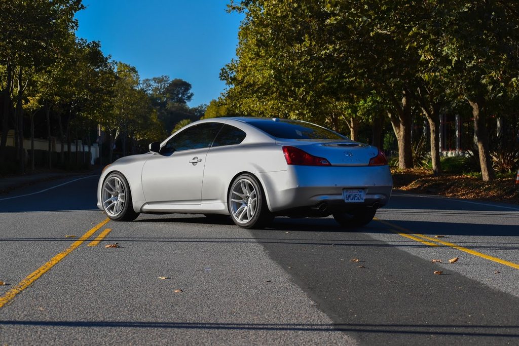

My girl sittin on Tein Flex Z coils. 19x10.5 square, 255/40 tires no spacers
