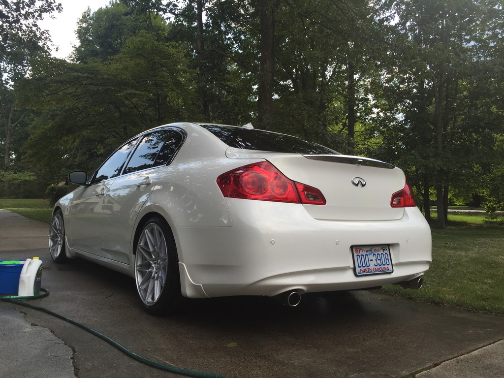

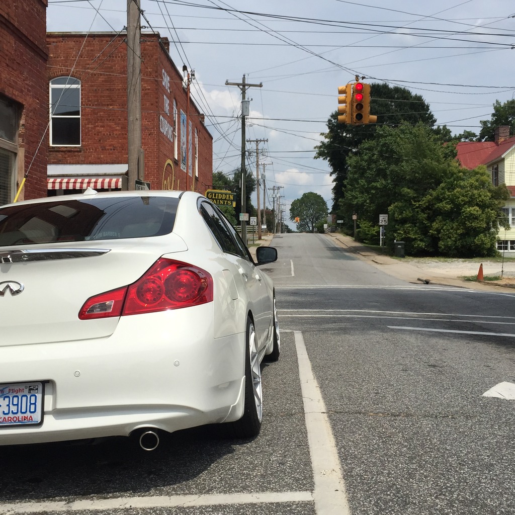

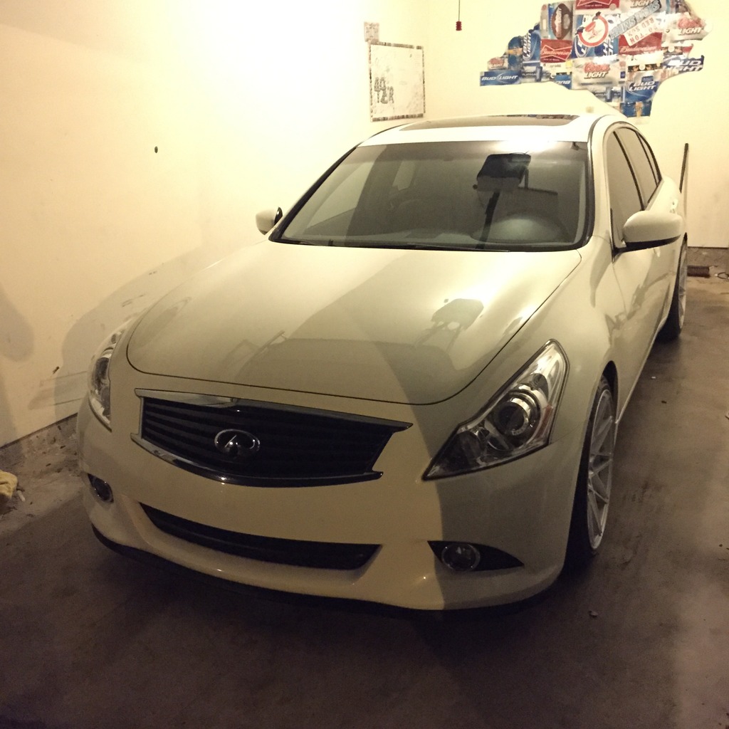

HELP~All squared setups please post here!
These are pretty much square. They will be when I put a 5 mm spacer up front
19x10 +45 front
19x10 +40 rear
255/35/19 all around
Eibach springs
*19x10 +40 is a perfect square setup if you're looking to leave enough room not to rub and not to poke out too much*
DO NOT GO HIGHER THAN A +45 in the front if you have a ten inch wide wheel. You will rub on the front spindle or whatever it's called

How much camber you need to run to fit those? Fenders pulled?
Natural camber, no fender mods no and camber kits reqrd.
Old Sep 12, 2015 | 08:23 AM
  #244
Likes: 4,952
Nice fit Gregor, looks like you did your homework That upper section of the steering knuckle can cause problems w/ too much positive offset, glad you pointed that out. It's even worse for 17 or 18" wheels as it has that drastic curve that really gets in the way for smaller diameter sets.
VA55, post more pics when you can, great job w/ those 10.5s.
Old Sep 12, 2015 | 05:11 PM
  #245
Gregor12's Avatar
Gregor12
Joined: Sep 2014
Posts: 659
Likes: 111
Thanks man. And yes! The 19s are right in the deepest part of the curve! If I turn the wheel all the way I think it rubs just a little bit. Going to add some spacers and studs in the front.
