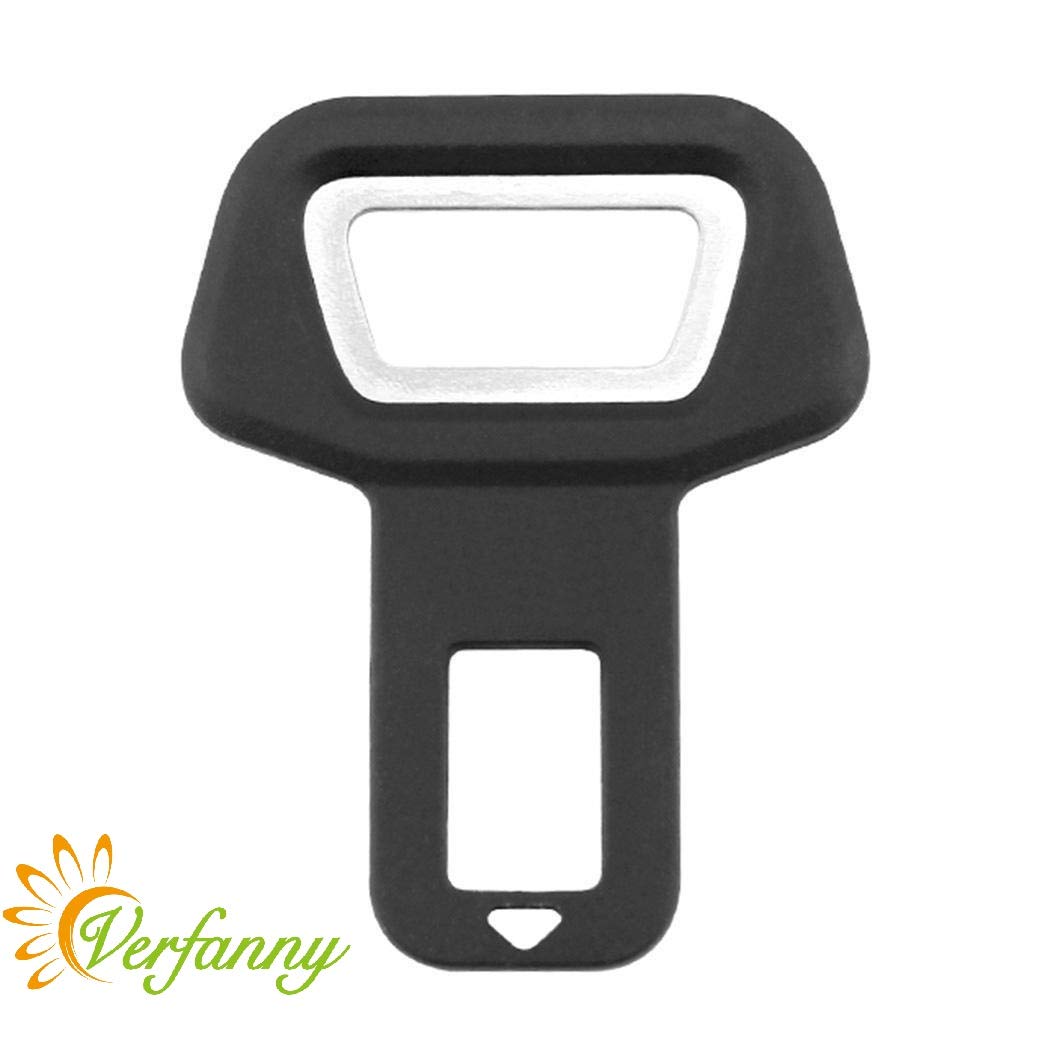

yeah its on my coupe. once i installed it, the air bag light went away for the passenger occupancy. but it told me that the passenger seat belt needed to be put on.
https://thetikit.com/collections/cars-trucks-2
they also double as a bottle opener lol

Yes, I finally got a chance to install it yesterday. It does keep the airbag light off, but for some reason it puts the seatbelt light on for the passenger seat now unless it is buckled so they must not have figured that part out in the wiring.
Thanks for the suggestion for the seat belt fake buckle. I guess I will need to get one of those, but remember to take it out every time someone sits there. Strange, but I understand it. It is annoying, but definitely the easiest way around the occupant classification sensor. I don't have people ride in that seat very often so I am ok with it.

No idea what the connectors are like or how any of it looks, but would you be able to get a seat belt receptacle thing off a wrecked G, connect that to whatever wire or sensor knows when it's buckled, then put the seat belt cheater into that and have it tucked up under the seat?

Yeah that was the reason for me getting the fake buckle. i dont want to have the seat belt plugged in when im in the car by myself so i just threw in the buckle cheat. its cheap and easy and no need to mess with wiring. they are cheap enough. i might have another laying around somewhere. i just gotta find it. not sure where i put it.

That would be another possibility. I will be fine with the fake seat belt buckle since I don't have people ride with me very often. It's just a simpler solution.

I ordered a very similar seat belt buckle off of amazon that should be here tomorrow. It can also be used as a bottle opener. Are they trying to promote drunk driving?!?

So I put in the fake seat belt and it works well. It looks a lot better than driving around with the whole seat belt latched. In fact, it is so small that you really don't even notice it. Good solution for a dumb problem. Thanks for the suggestion Louith.
