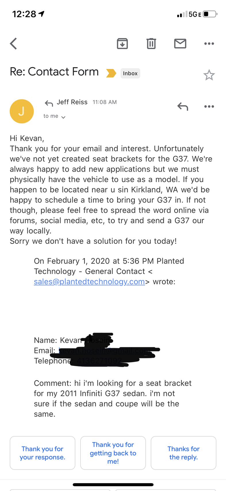

Anyone around Kirkland WA
Attached Thumbnails Has anyone replaced the front seats in their sedan?-photo385.jpg
Old Feb 3, 2020 | 02:20 PM
  #393
4DRZ's Avatar
4DRZ
Posts: 4,724
Likes: 697
From: Appleton, WI
That is the same response I got from Planted when I contacted them about seat rails for the sedan a few years ago. Looks like no one stopped by their shop yet with a G37 sedan.

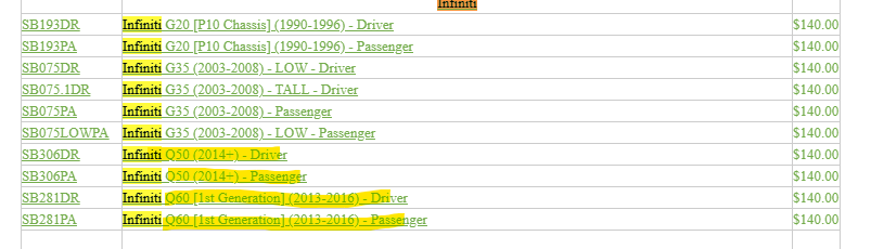

i found something interesting. this youtube video states that the infiniti Q60 brackets fit the G37 coupe. what are the odds that the Q50 ones would fit the G37 sedan?

So I got another tidbit of info. Someone said that the g35 brackets fit the g37.
looking at planted’s application it shows the same bracket for the coupe and sedan. It also shows the bracket is up to 2008. I’ve got some in my amazon cart has anyone heard of someone trying the g35 brackets with the 37?

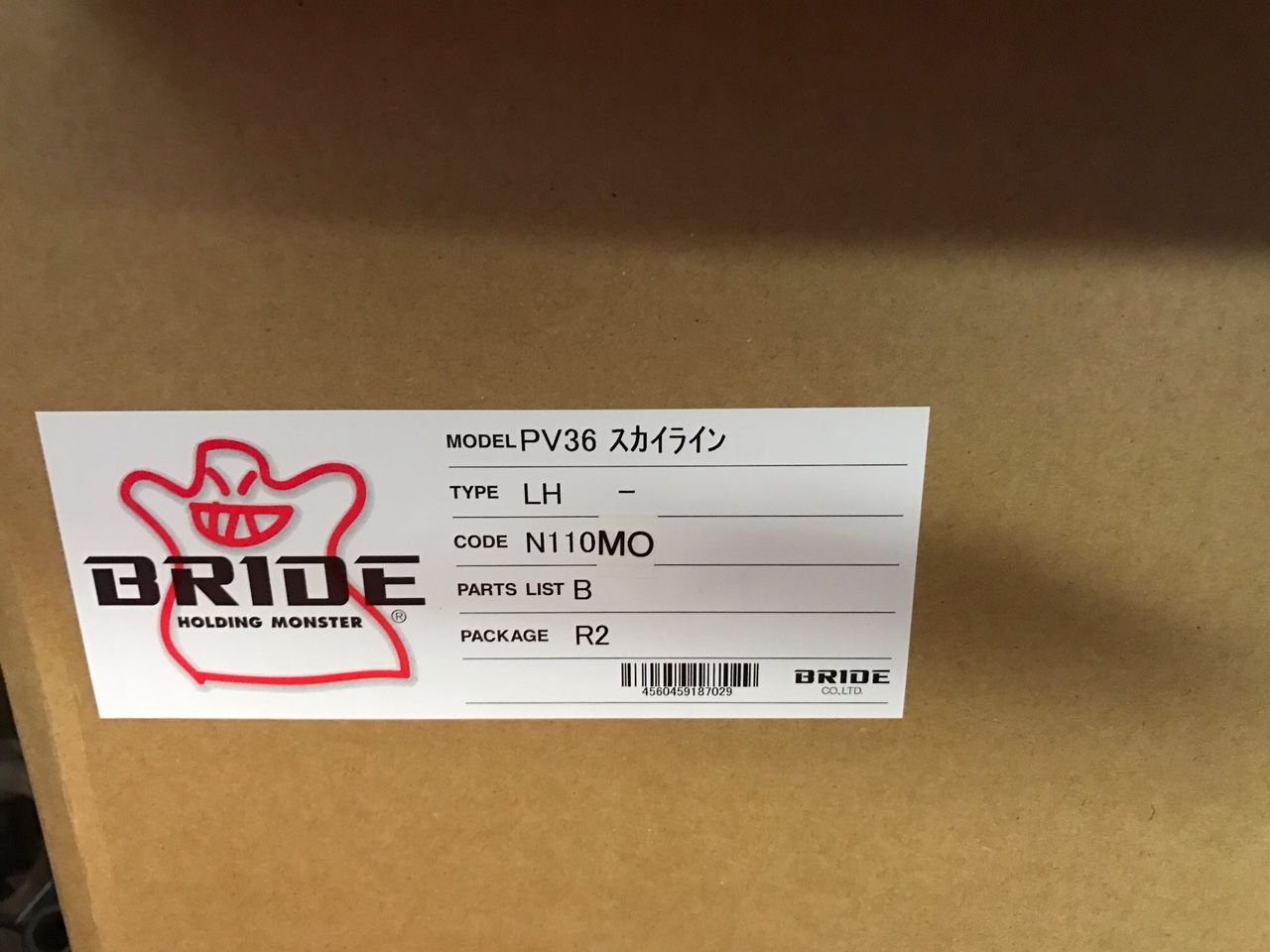

I have a 2008 G35 sedan (V36 chassis; same as the G37 sedan) and I can definitely confirm that the G35 (V35 chassis) brackets DO NOT fit the G37 sedan (V36 chassis). Unless you are talking about the 2007-2008 G35 Sedan brackets, then yes, those are the same as the G37 sedan since they are both the same V36 chassis. I can also confirm that neither the G37 coupe, nor the 370Z brackets will work in our cars (without completely modifying them with new mounting brackets). Like 4DRZ, I researched this issue for several months and and the only brackets I could find that fit the V36 sedan (without modifications) are the ones made by Bride. You should be able to find these for under $200, so why not just order the ones from Bride and use what you know will work?

Hey Guys! This is a awesome thread! Thanks for starting this 4DRZ. I have read through this thread a few times now... There's a ton of great information. Question for you all with your racing seats installed, using OEM seat belts. It occurred to me yesterday that OEM seat belts are bolted to the stock seats... How are you attaching them to your aftermarket seats/rails? I'll be starting my project in a few weeks. If all goes well, everyone that has a G37 Sedan will have a alternative to Bride rails and more seat options (stay tuned for that)
Old Mar 2, 2020 | 03:38 PM
  #401
4DRZ's Avatar
4DRZ
Posts: 4,724
Likes: 697
From: Appleton, WI
I'm curious to see what you have planned. The Bride seat rails include their own mounting point and hardware to transfer over the oem seat belt clip. I am not sure how common that is among aftermarket seat companies, but I would guess that it is pretty rare.
