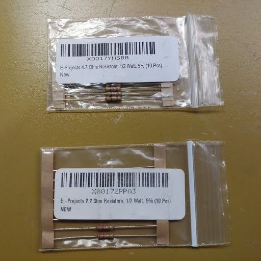

I tried 2.2 ohm earlier, but it did not work with my car at all. However, that may have been due to a bad connection. I have had pretty good luck with a 4.7 ohm resistor, but it can sporadically trip the airbag light. If I have had (relatively) good luck with a 4.7 ohm resistor would it make any sense at all that a 2.2 ohm resistor would also work?
I am surprised that an electrical resistor would be so sensitive to temperature compared to the rest of the seat wiring, but I am willing to believe anything is possible at this point. I did not see the airbag light yesterday or today so using Murphy's law I am sure it will come on during the drive home tonight... Hopefully, I am wrong.

So I got a chance to replace my 4.7 ohm resistor with the 2.2 ohm resistor that 2gornot2g uses. I tried this once before and it did not work, but I may have had a bad connection. I checked the connections on the old 4.7 ohm resistor and they were solid. I had one of my techs solder the connectors onto the resistor so I am not sure if a connection failed under the shrink wrap (unlikely) or the resistor failed. Whatever it was my car was throwing the airbag light about every other day. This resistor has worked well for quite a while until recently.
original 4.7 ohm resistor soldered to connectors and shrink wrapped
4.7 and 2.2 ohm resistors
2.2 ohm resistor with original wires wrapped around it
everything wrapped in electrical tape

Well, it has been about 2 weeks with the 2.2 ohm resistor and the airbag light has remained off (knock on wood). We have had some extremely low temperatures lately too (-15 degrees right now) so that does not seem to affect it. If the light comes back on I also picked up a Craftsman multimeter pretty cheap since our local sears is closing. Every technician I talk to is scared to pop the airbag in the factory seat by checking the resistance, but I might be willing to take that chance if the airbag light keeps appearing.
