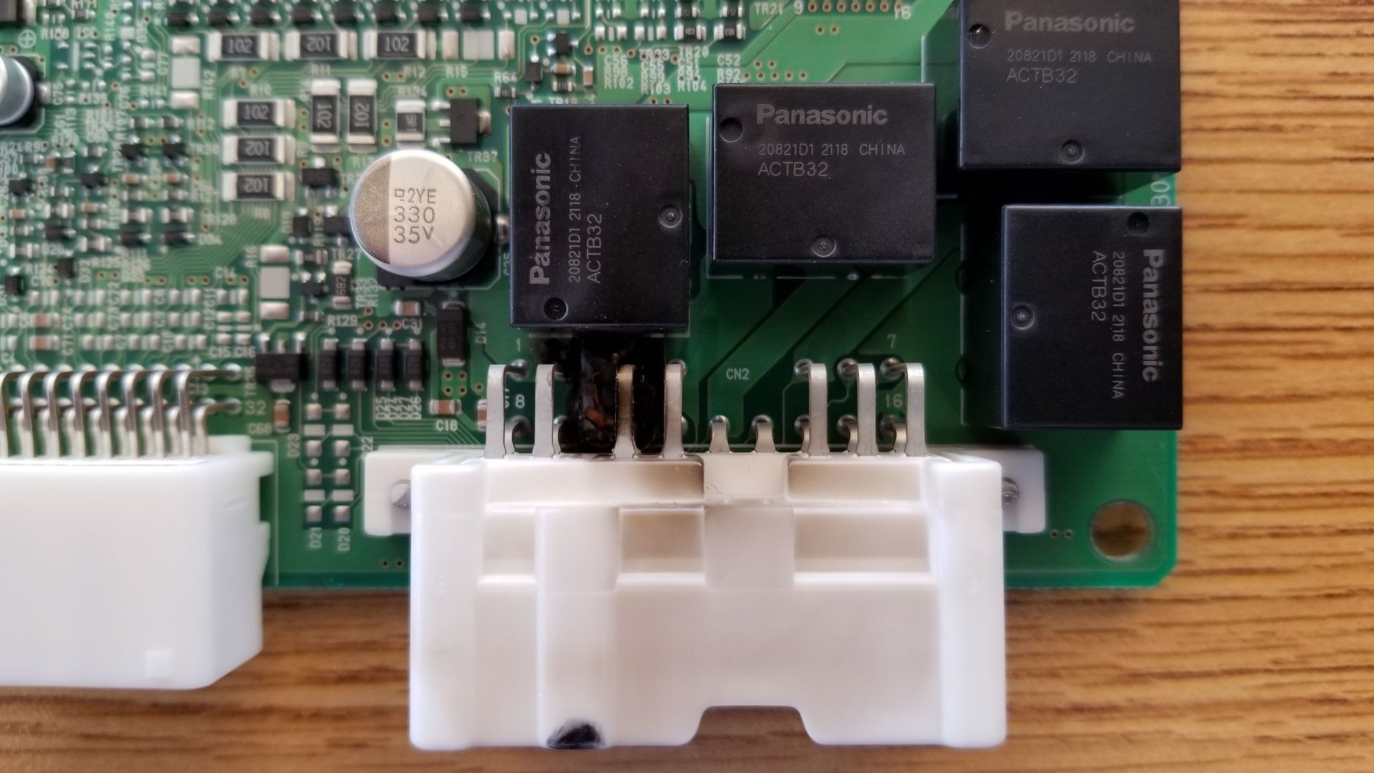

We were finally able to find the cause of my factory seat not moving forward and backward. Turns out the "brain" of the seat probably got fried when I plugged it directly into the wiring in the floor trying to get back my power mirrors based on a suggestion by another forum member *cough* 2Gornot2G *cough*
So do NOT plug this directly into the wiring in your floor unless you feel like sending your electrical system into limp mode and towing your car into the shop.
Here is the circuit board from inside. Just below the black Panasonic box on the left you can see where it got fried.
Hahaha. Don't blame me... I specifically mentioned that you would need to keep the wiring harness from the factory seat to plug the box in. I never even considered trying to plug the control box directly to the chassis wiring harness, so I'm not sure where you got that information from. I even posted a pic of the part number on the wiring harness I purchased so I wouldn't have to pull apart my OEM driver's seat. See posts 107 and 117 in this thread.
Thankfully replacement seat control modules are inexpensive on ebay so it shouldn't be costly to fix.

Yeah, I agree. Seems crazy that they would make the connectors the same so you could "accidentally" (or not so accidentally in your case) plug the chassis harness directly into the seat control box.
If you decide you want to use the control box to keep your mirrors when you have the Sparco seat installed then I would suggest picking up a used driver's seat wiring harness off ebay. You can get the part number off your OEM wiring harness that installed in your OEM drivers seat and just match that. The only caveat to this is that you will have keep the entire wire harness intact so you will have a whole bundle of extra wires under your seat.

That's kind of what I figured about the wiring harness. I was planning to use the one from my factory seat, but it is really not a big deal to lose the power mirrors. Now my wife won't change them the few times she drives the car.
Logically it makes absolutely no sense that plugging the wires from the car into the wiring harness that is not plugged into anything = OK, but plugging the wires from the car directly into the control box = short out the control box and throw your car into electronic limp mode so it has to be towed to the dealership.

There's power running through that chassis harness and it is meant to fed through the seat wiring harness first... and by plugging it directly into the seat control box you sent power to the wrong terminals on the control box which obviously blew a circuit in the control box. It isn't uncommon for car manufacturer's to use the same style connector in multiple places on a car so you do have to be very careful when messing with the wiring on modern cars. The G also has two of the same connectors behind the HVAC and radio so you have to be very careful when removing and reinstalling the dash pieces too.
