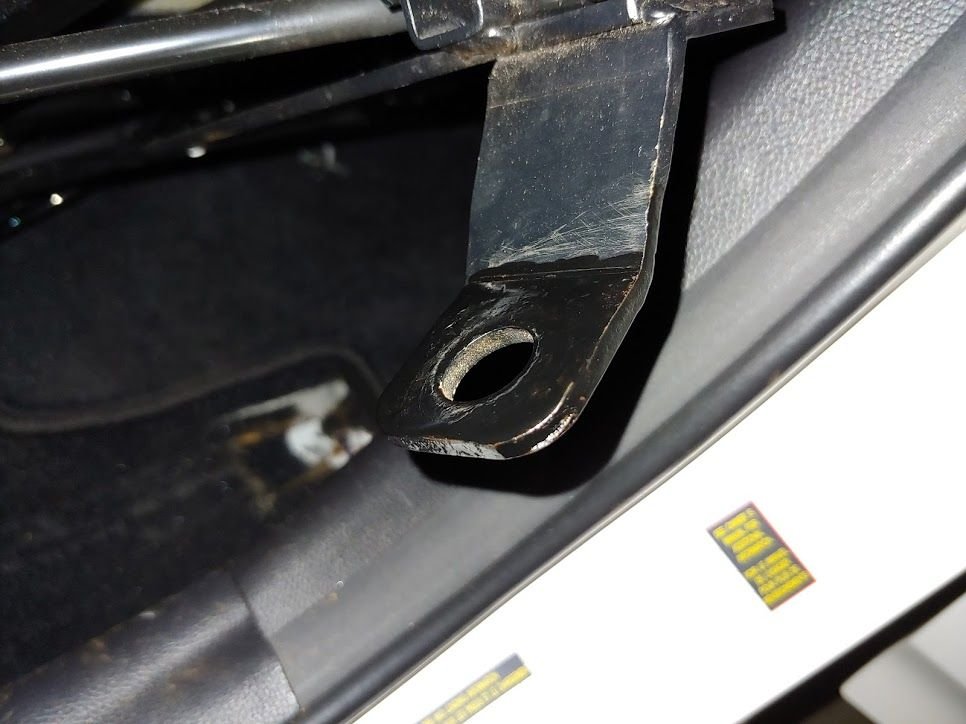

I replaced the resistor on the driver's side the other day and the airbag light went away. I wonder if I need to switch to a better brand of resistors or if I need to measure the actual resistance of my factory seat and hope that the airbag does not go off. 2GorNot2G or has anyone else actually run the resistance on their factory seat without setting off the airbag? I am really hoping to get this figured out before I get a Sparco seat for the passenger side too.
The good news is that I figured out that if I stretch the wiring a bit I can actually change the resistor without having to remove the seat. So this could definitely save me some time if I keep having to replace the resistor every 6 months or so.
The other thing I did was sand down the rust on my custom height seat rail on the outer brackets and repaint them. This was probably due to a combination of the aftermarket paint job, salt in the winter, and having to remove the seat a bunch of times. Hopefully, I just solved at least 2 of the 3 issues.

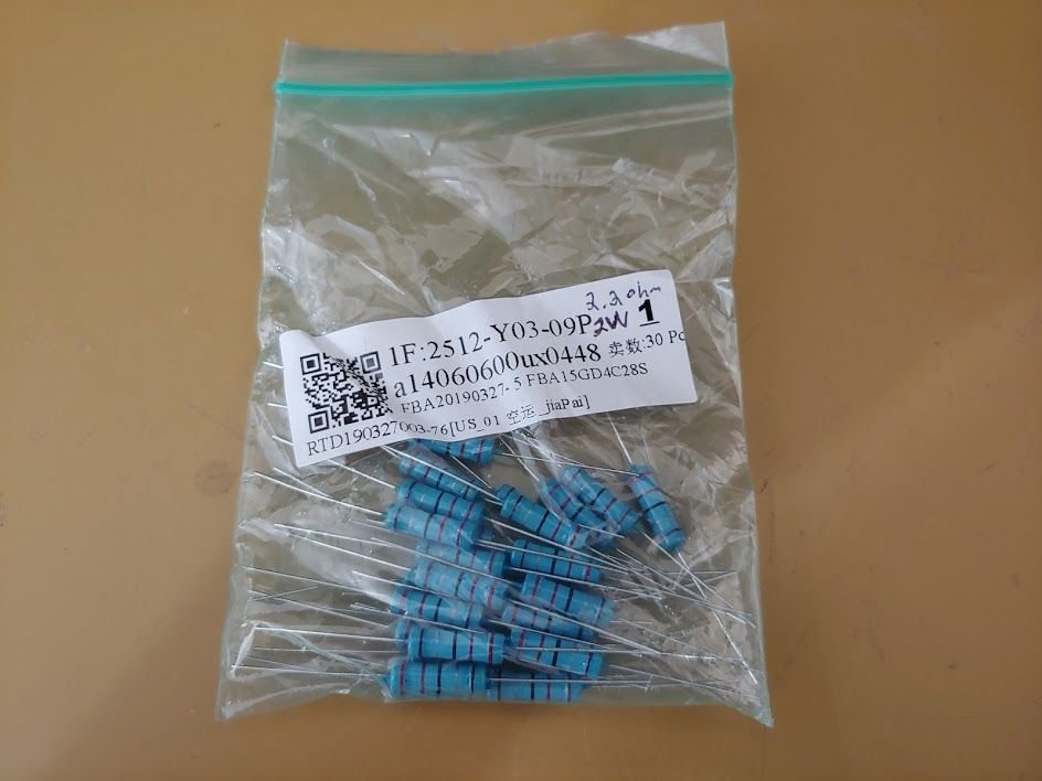

Thanks to 2GoRNot2G's suggestion of moving up to 2W resistors instead of 1/2W resistors, I installed one yesterday on the driver's side. I drove around a lot yesterday and today and it seems to be holding up well, but only more time will tell for sure.

W=Current * voltage
W = *current^2) * resistance
Several other variations to the formula too. Figure out the voltage drop across the resistor, the current through it, then get a resistor 2-4x of power consumed. That should give a good margin for heat dissipation.
2.2Ω is very close to a short.

"If the resistors keep failing it's completely possible that you are using too low of a wattage resistor. Using Ohm's law, P = I x V (where P is the power in wattage, I is the current in amps, and V is the voltage) you can calculate the amount of current (amps) that a component can safely handle without failing and in the case of your air bag resistor, how much power it can safely dissipate without overheating. Solving for I (amps) the equation becomes, I = P/V... So for a 1/2 watt resistor it would be rated for only .04 amps @ 12 Volts (.50/12 = .04) or ~40 mA, but if you used a 2 watt resistor it would be rated for about 4 times that or .166 amps @ 12 Volts (2/12 = .166666), or ~166 mA. So if the air bag circuit in your G has a current greater than the resistors rating then the resistor will eventually overheat and fail. I'm not sure what wattage resistor you are using, but here's a link for 2 watt, 2.2 Ohm resistor... Might be worth a shot if they keep failing."

How do I know... Because any low value resistance results in high current. As indicated, power (wattage) is a product of voltage and current, so say you have a 2Ω of resistance load on a 12 V circuit, that's 6 amps (12V/2Ω); 6*12=72 watts. That's just a basic series circuit example.
In your case, the resistor is going inline to the seat, so there's voltage drop across the resistor and another drop across the remainder of the circuit. While the instrument used to measure the current does affect the circuit slightly, the resistors used would affect it more so.
Do these failed resistors result in an open or short? Do they show discoloration signs of burning (smell?).
You could also indirectly obtain the current. V=IR, so I=V/R. That should be easier to measure. Measure the resistance of the resistor first. Then measure the voltage across the resistor on an energized circuit.
So say R=2Ω, and voltage across it is 2.5V, current then is 2.5V/2Ω or 1.25A (that's still a high amperage). So you'd need a resistor rated at 2.5V*1.25A or at least 6 W (2x margin for safety).
Hope this makes sense.. Goal should be to minimize the current/power across anything additional you add to the circuit (for safety reasons).
