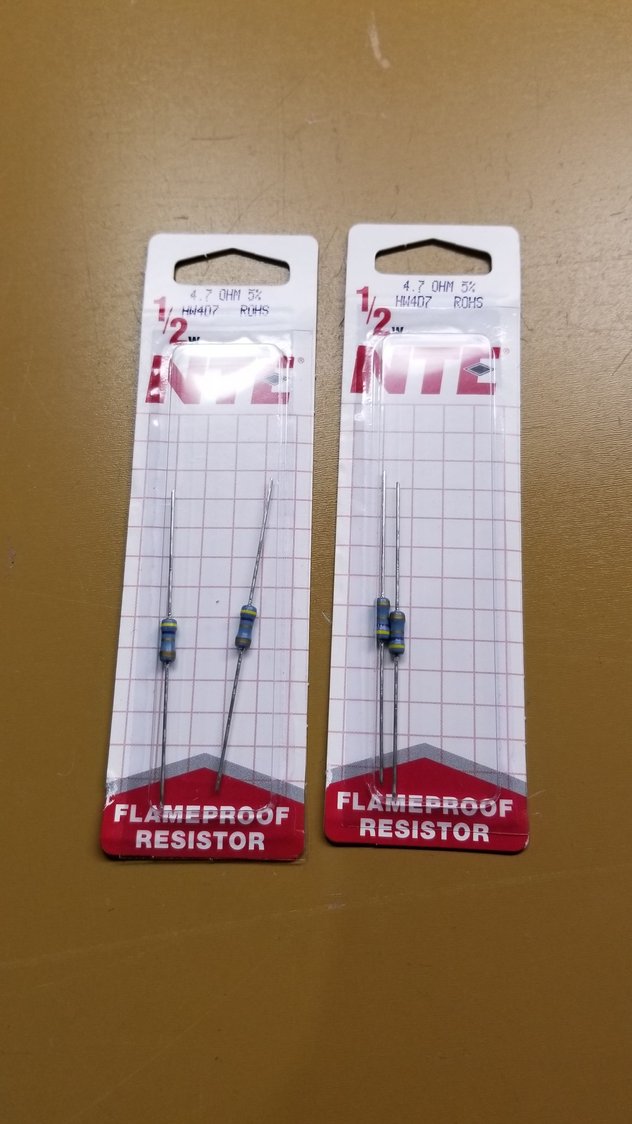

Hey you're back! I have a multi-meter, but it is not digital and does not go that low. ttv36 above mentioned that the wiring changed for the newer cars so I am going to pick up a 4.7 ohm 1/2 watt resistor today and try that.

I splurged and spent $3.12 on two packs of resistors in case something goes wrong. Got them installed tonight and reset the airbag light. Hopefully this will be the end of the annoying flashing airbag light... fingers, legs, and arms crossed while I knock on wood for good luck.

Strange. I'm running 2 ohm resistors in mine without any issue and my buddy is running 2.2 ohm resistors in his G37S coupe (also a 2008 I believe). Both have been working fine for well over a year.
You're just flukes
Looks like the right ones to me, here's to hoping!

The 4.7 ohm resistor did nothing. I cannot even get the airbag light to reset at all now.
2GorNot2G- did you ever drive your car without the wiring harness attached? Maybe that is my issue.

I left my battery unplugged for well over 24 hours and did the on/off sequence to reset the airbag light only to have it turn on instantly.
It seemed odd so I took another look at the wiring of the relay. It turns out that one of the metal tabs on the plug was bent up and actually going over the connector instead of into it. I bent it back, plugged it back in, and tried resetting the airbag light again.
Unfortunately, it just flashed the airbag light in code that it was reading an issue. Sometimes that would happen and then reset when you restart the car. I restarted it and the airbag light finally went off. Hopefully, it stays off for good. Fingers crossed... again.
