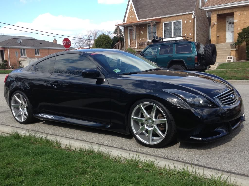

Yup I'm running a staggered setup on my X with no issues. Like everyone said just keep your rolling diameters the same and you'll be all good. 245/35 and 285/30 tire sizes are recommended.
Here's my X on CV7s
