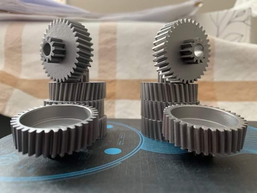

Stuck with broken flap on you vert? You're not alone...One of the most common problem known on Infiniti vert's!!!
got machined made metal gear replacement for oem plastic gears. Sold by pair.
easy to diy install in less than hour, no special tools needed except of rivets.
need some? Email me for more infos

Old Apr 11, 2022 | 08:14 AM
travlerv's Avatar
travlerv
Joined: Jan 2022
Posts: 6

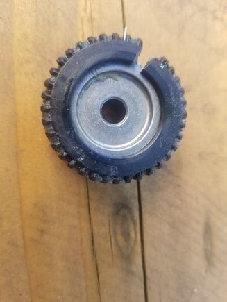

I dont see the outer gear. Isnt it that one that brakes? Is there any way you can show a pic tof the assembly part with a broken gear and assembled part with your new gears? It just be nice to see how everything looks. Before & after pic.

2012 to 2015 oem broken gear
My metal gears (all assemble and ready to replace) for 2009 to 2015 models
2009 to 2011 oem broken gear
