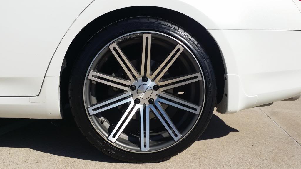

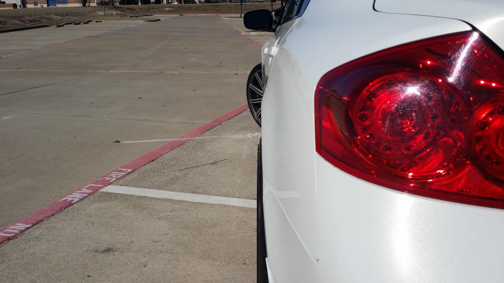

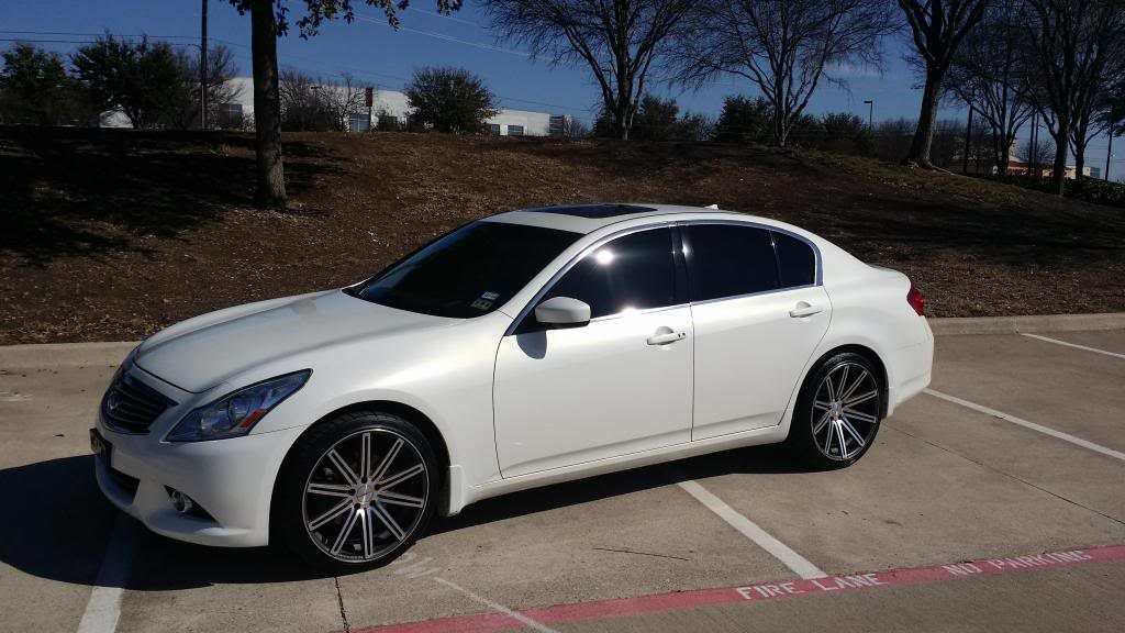

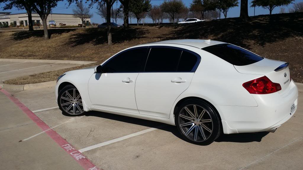

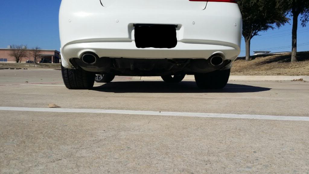

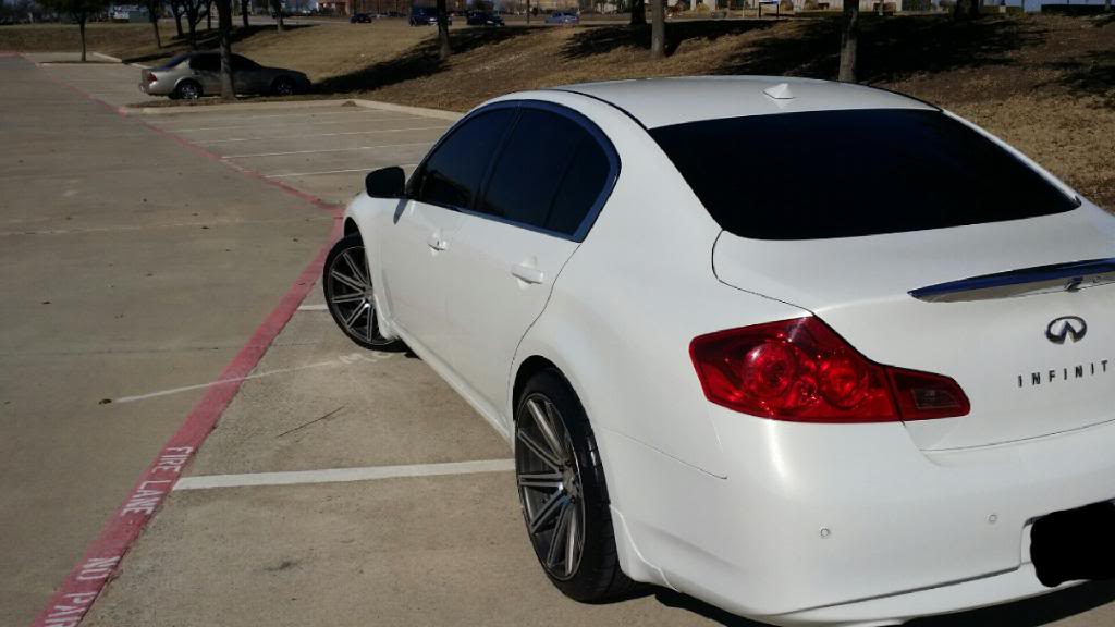

Got them mounted today, 245/35 up front and 285/30 out back. Vossen CV4 20x9 +38 and 20x10.5 +45.
Drop to come shortly.

Old Mar 10, 2014 | 08:13 PM
  #129
pebkac's Avatar
pebkac
Posts: 241
Likes: 22
From: Austin Tx
Clean ^^

  #130
Likes: 4,952
Gonna be a great fit w/ the drop G374U2NV, post more pics when you're down.
