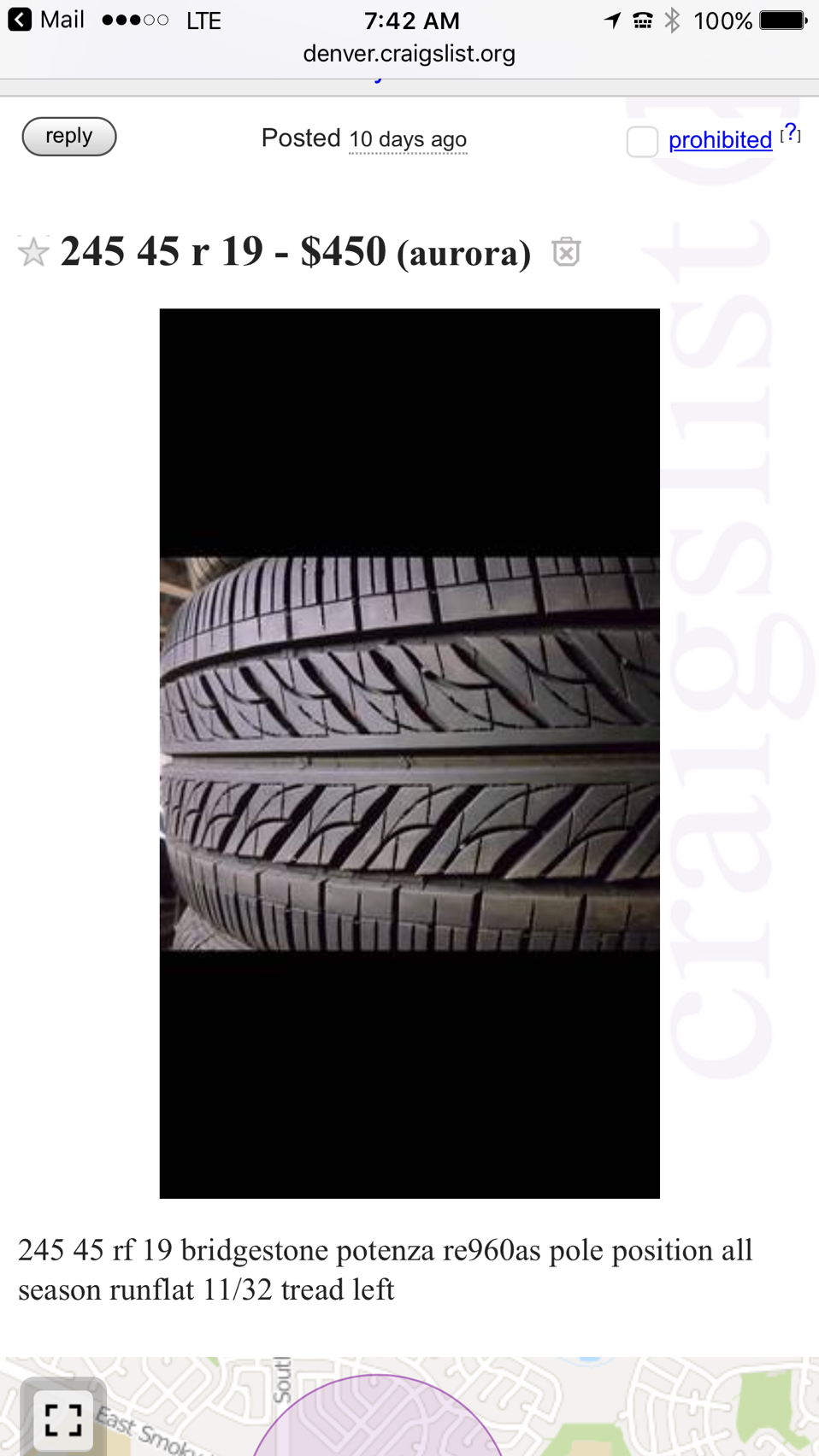

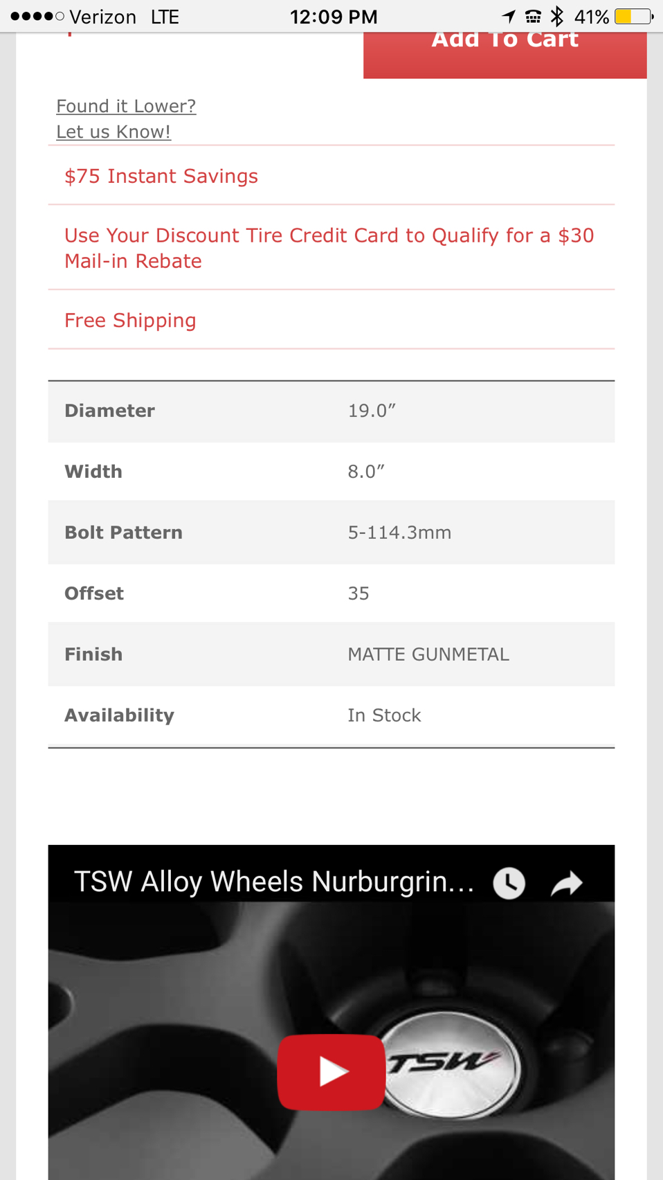

I know you guys mentioned a lot of numbers but this is one you didn't mention so I'm wondering if they will work with my 2010 g37xs sedan lowered on swifts
The tires are 245/45/19 with my 19x8 35 offset.
The OFFICIAL "I have a wheel offset / tire fitment question!" thread-photo462.jpgThe OFFICIAL "I have a wheel offset / tire fitment question!" thread-photo260.jpg

Why don't you want neg camber? These cars need camber to uphold to handling dynamics it was designed around. You could run either of those set ups with a coil drop, probably looking at a 245/35 front and 255/35 rear.
Attachment 123867Attachment 123868
245/40

Originally Posted by VenomGT9
245/40
You sure? I would hate to pass up this good of a deal if it can be done.
Old Sep 22, 2016 | 02:26 PM
  #1628
Likes: 4,952
Be about an inch taller, and over 3% from your OEM diameter. Guys have done it, not sure if any long term issues would arise though???

I think I'll play it safe and go with these. Can't believe how cheap she's selling them for?! No patches or holes...
