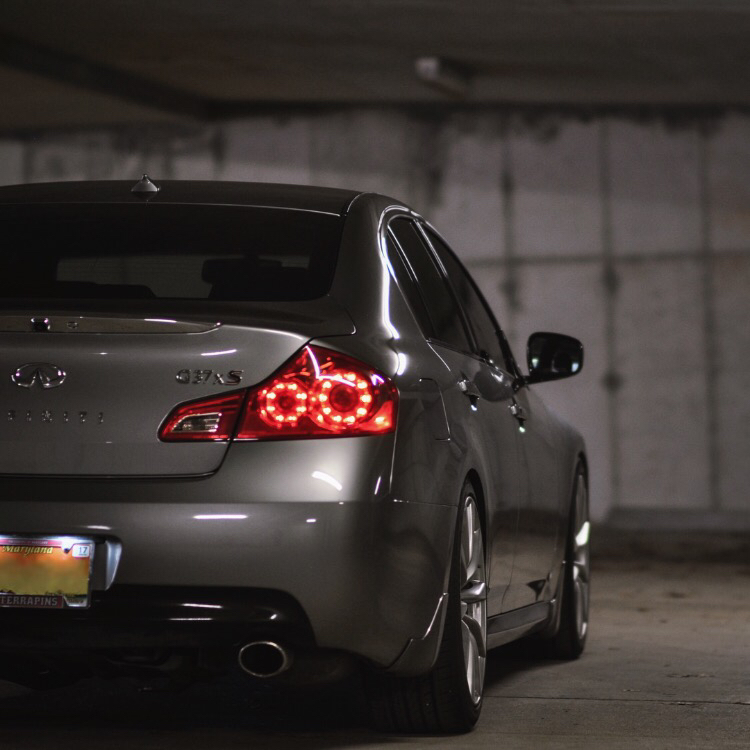

So I was offered a RIDICULOUS deal on a set of 18x8.5 ET 20 wheels. I'm struggling with my calculation of offset. Will that be an aggressive look on a rwd sedan? From what I've been reading I fear it's too aggressive and will poke out too much. My goal is as much meat as possible under the car and as reasonably close to flush setup as I can. The price (if they fit) is worth grabbing them until I get a wider set. May still go with 18s later, 19s max
Here's my AWD sedan with OEM coupe wheels. The fronts have 20mm spacers and the tears have 15mm spacers making final specs 19x8.5 +23 and 19x9 +30 respectively (I'm pretty sure). AFAIK the fit is the same at the fender between AWD and RWD. Hope this helps.
If you run 245 width tires, the tires will tuck just inside the fender edge in front, back will be fine, but the wheels themselves will be poking outside the fenders about 6mm further than mine (I'm running 9.5 +38, which equates to a 8.5 +26)
