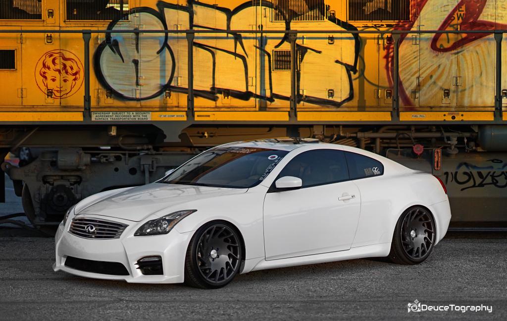

hotdawwgman's Avatar
hotdawwgman
Joined: Jul 2008
Posts: 491
From: Garden Grove
Square Setup. 20x10.5 +25 Running 245/35R20 Tires. -2.3 Front Camber and -3 Rear Camber. Perfect Fitment
