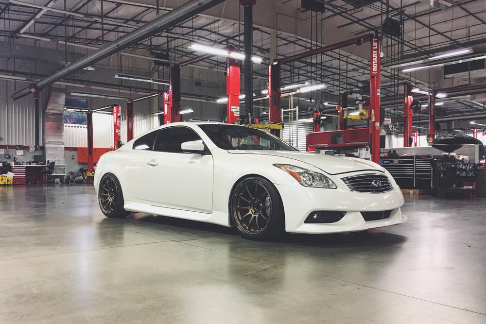

Hi All,
currently running 19x9.5 / 10.5 +22 on ZE40s and was wondering how difficult would it be to fit a 10.5 +12 on the rear? Here is how my current fitment is.
Current rear tire sizes are 255/35 I believe.
Old Mar 4, 2017 | 12:52 PM

Originally Posted by fatalblitz
Hi All,
damn thats beautiful, do you know how low you are front and back
Old Mar 4, 2017 | 02:42 PM
  #1830
Likes: 4,952
That's as aggressive as I'd recommend, it looks like one of the best fits I've seen fatalblitz. You could always camber out some more to stuff the +12s in there or run some stretched 245s, but yours is so functional now and you'll lose some of that IMO. But Kudos in your current state, well done!
