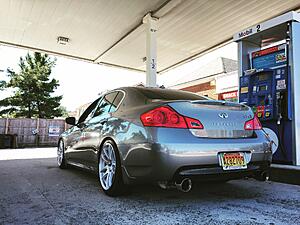

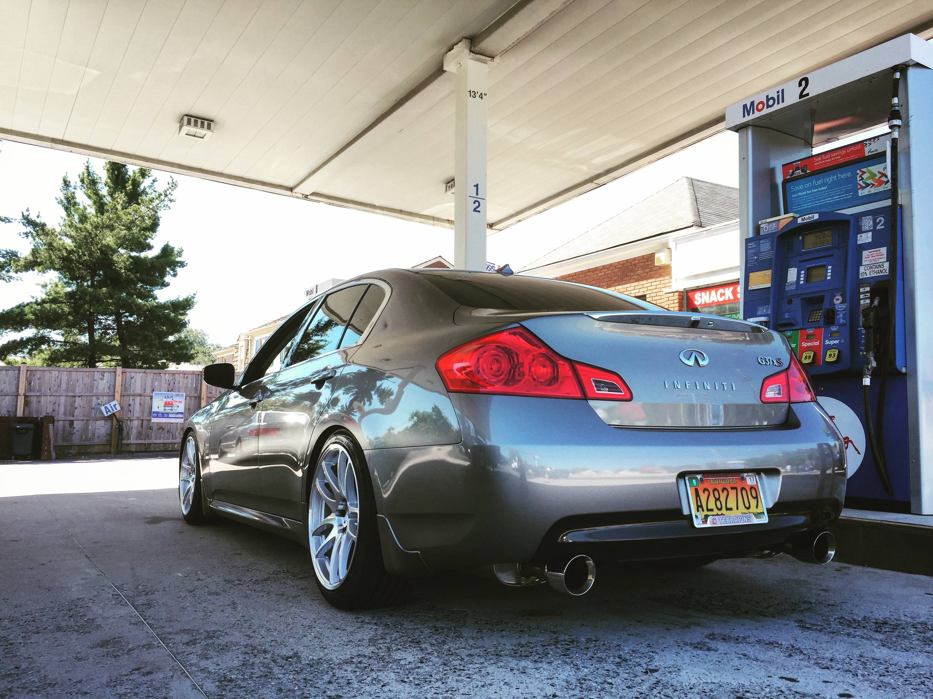

Here's what a 19x10.5 +22 looks like on a sedan. Thats with stretched tires and some camber. Not a fan of the look, but it's doable. https://www.myg37.com/forums/wheels-...ml#post4011933
Here's what 19x9.5 +35 looks like all around. IMO a perfect fit, no stretched tires or camber needed to clear. Much better suited for the sedan.

10.5 is a bit much for a sedan no matter how you set it up.
Find a more aggressive 9.5 to work with and you'll be better off especially when it comes to tires.
