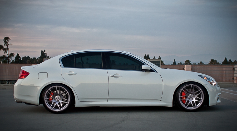

I am looking to get some gunmetal 19 inch Forgestar F14's, would like to be completely flush. This is for a G37 6MT sedan lowered on Swift springs.
Is +36F and +46R good for a flush fit lowered on Swift?
Also, what would be best?
19x8.5 on 235/35 +36
19x9.5 on 265/30 +46
or
19×9 on 245/35 +36
19×10 on 275/30 +46
I would like a completely square looking wheel/tire combo, no stretch and no bulge.
Posted Photoshop of what I would like it to look like.
Wondering though if I need 20's instead of 19's though to achieve this look.
Thank you!
Attached Thumbnails The OFFICIAL "I have a wheel offset / tire fitment question!" thread-f14.jpg

I would go with the wider set, with those offsets you shouldn't have any issues with being too aggressive. However make sure that they clear the BBK. Also with tires you want to bump up your sidewalls to 40 front and 35 rear for 19 inch wheels.
Agree w/ 93 (as usual, lol) you'll get a better ride and the diameter will be much closer to OEM. Since Forgestar allows for custom offsets you'll have no problem getting right to the fenders. Here's some pics of my G when I was running 20s. I ran 8.5 +40 front on 245/35/20 and in back 20x10+45 on 295/30/20, in back these were perfectly flush, I had more room in front since the front fender isn't flat-rolled like the back.
Old Nov 22, 2016 | 09:57 AM
  #1724
And here's another set of pics with 285/30/20s in back, as you can see the 295/30s are real flush (perfect IMO) and the 285s have a bit more room.
Old Nov 22, 2016 | 10:09 AM
  #1725
So in short, if I could get custom offsets and want a nice aggressive setup I'd run 19x9.5 Deep concave in a +40 running 245/40/19s and a 19x11 Deep concave in a +55 running 275/35/19s (Assuming there is enough inner clearance, I can check on this later if you'd like). This will give you a similar deep concave on both front & rear wheels (a much better look than a semi concave front, deep concave rear) and the tire mount will be the same front & back with both tires being a similar slight stretch mount. The 245 on a 9.5 and a 275 on a 11 are both the max recommended widths for both those tire sizes. This will be a very nice looking set & fit. BTW, Jason@GetYourWheels is running a great black Friday sale on Forgestars and is a great guy to deal with, he'll confirm brake clearance and get you taken care of. HTHs,
Brad
