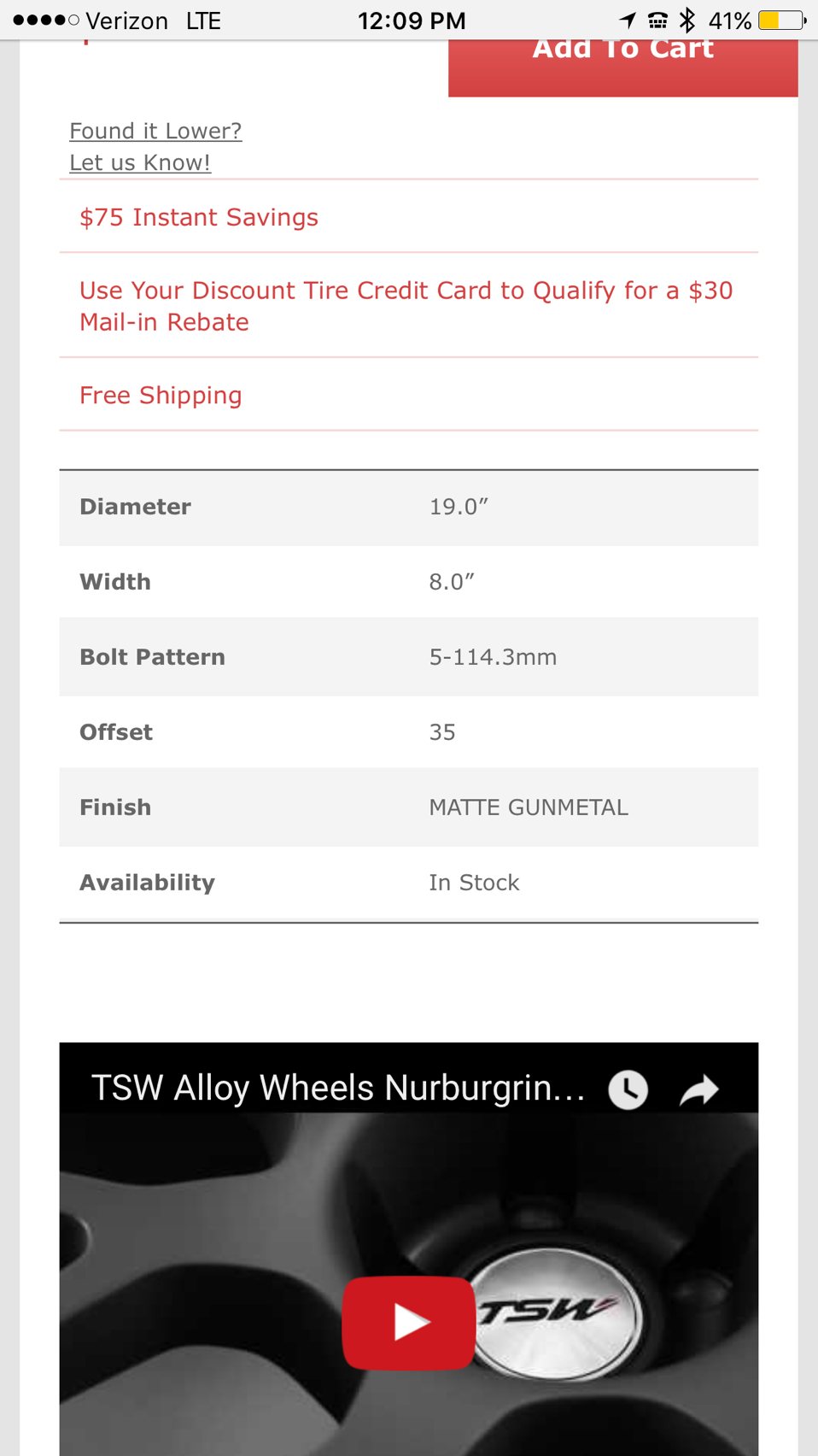

Old Sep 20, 2016 | 12:05 PM
  #1619
Mattyem's Avatar
Mattyem
Joined: May 2016
Posts: 325
Likes: 22
Hey I'm buying new all season tires for these wheels and I do plan on putting Swift springs on my 2010 g37xs sedan eventually (probably after winter) so idk if that has anything to do with it.
What are the numbers I'm lookin for when purchasing tires? I was thinking about looking at Craigslist first but I have no idea what to search for!
The OFFICIAL "I have a wheel offset / tire fitment question!" thread-photo184.jpg
Old Sep 20, 2016 | 12:37 PM
  #1620
the93owner's Avatar
the93owner
Joined: Jul 2015
Posts: 1,397
Likes: 335
I assume you're going with a square setup? I would recommend 225/45/19 on all 4 wheels.
