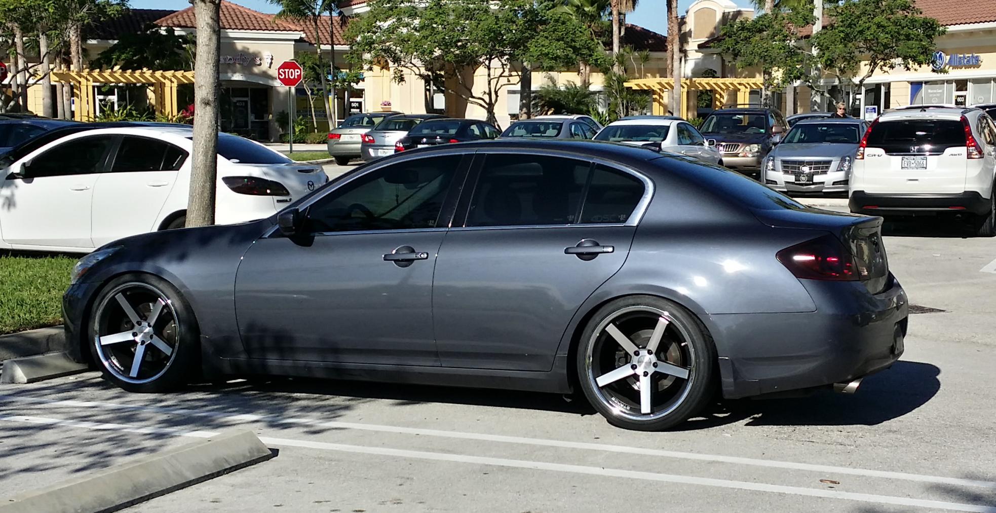

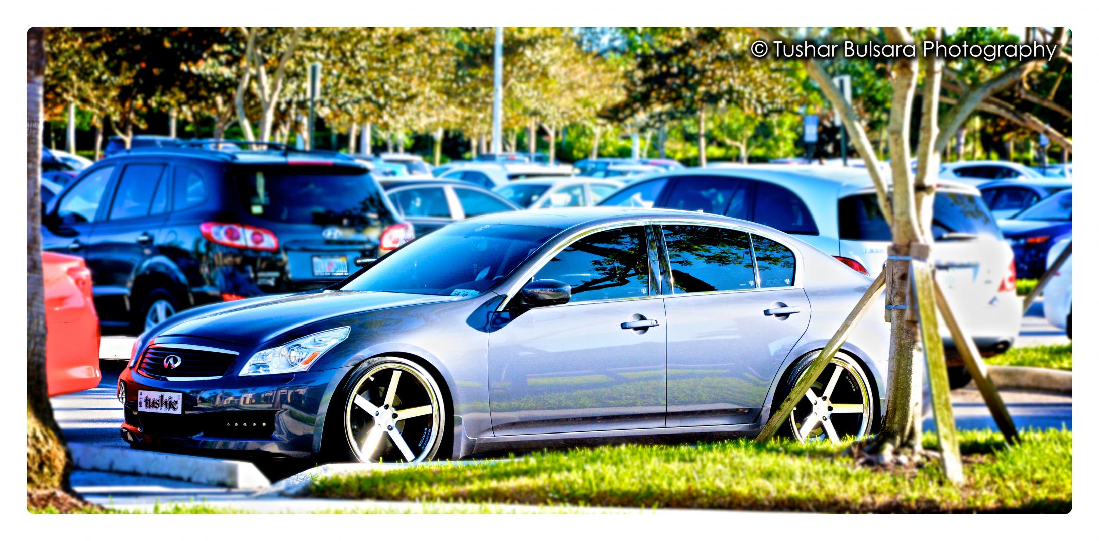

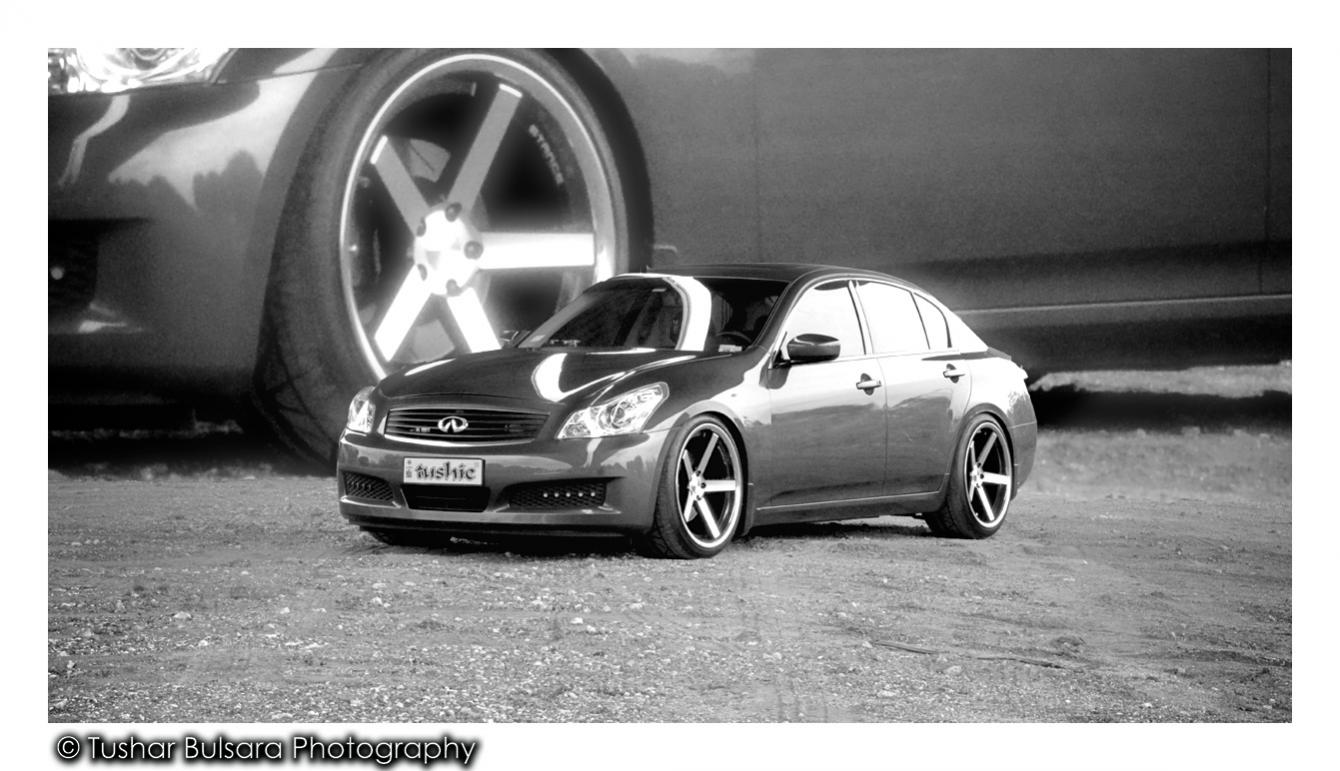

im running 20x10.5 +35 all around on 275/30/20 nitto invo. lowered on D2 Racing Coil overs.
IMO, 40 is to thick for the back, 35 or 30 would be good.

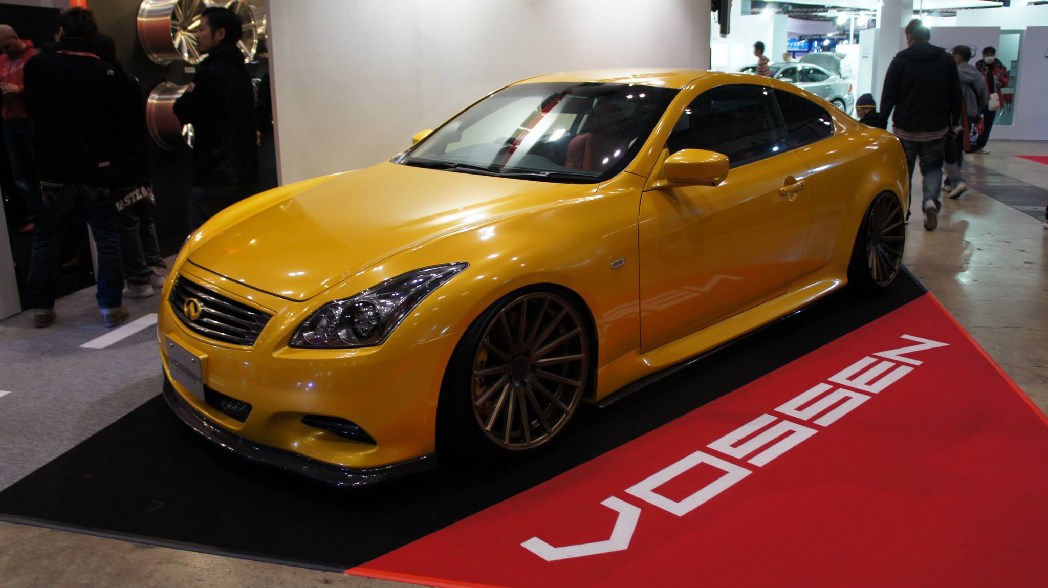

late post from my tour in tokyo auto salon 2014
Vossen g37s coupe
