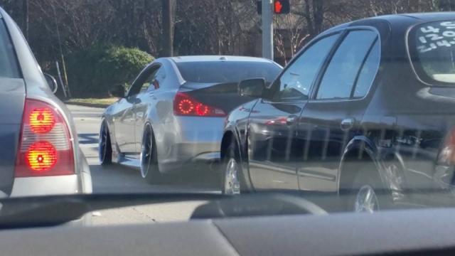

^^^Because you are speechless or you hate it?
That's his own car if memory serves me right lol

What are those rim specs?
Eat through tires with that camber (btw what is your camber)?
