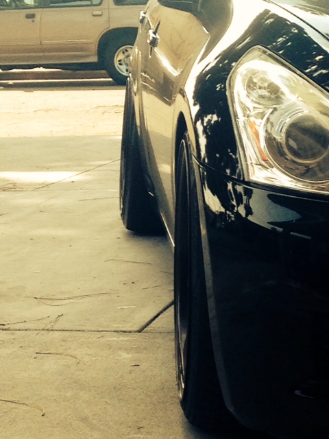

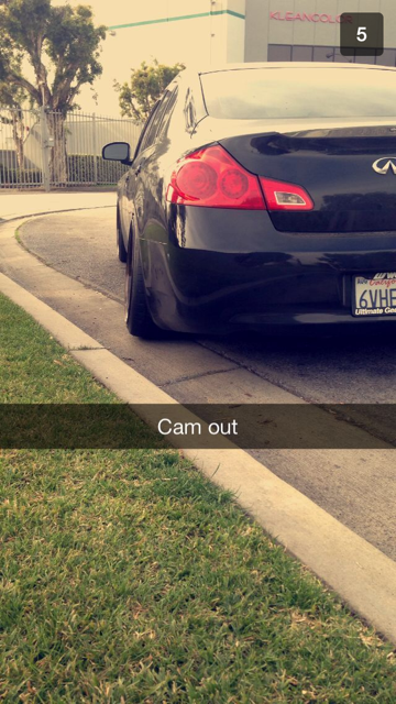

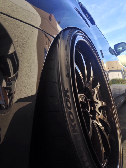

Yeah Iam lol 9.2 +12 225/35/19 front
and 10.5 +22 Rear 255/35/19 got nice little stretch
Slammed on Stance SS coils and SPC camber arms
