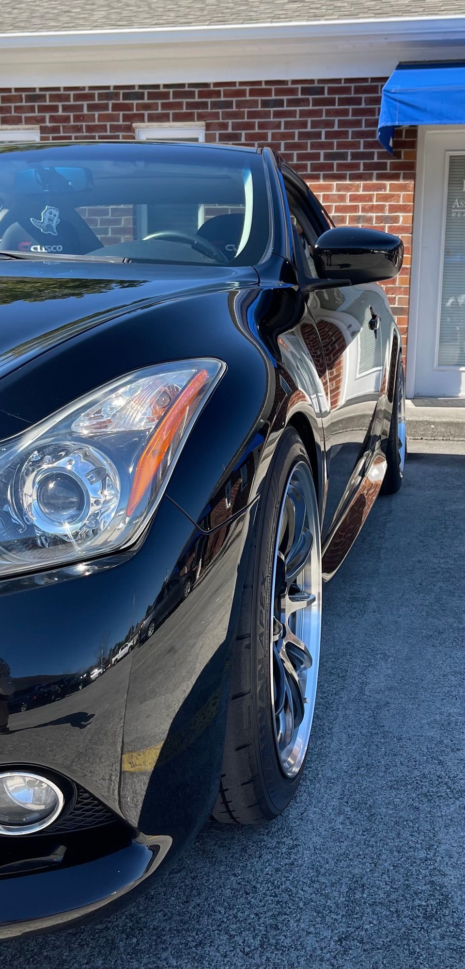

No one has posted in this thread in almost 2 years? I have no shame in reviving this thread, I'll be that guy
19x9.5 +23 front and 19x10.5 +30 rear (swapped from +23 rears, same exact wheels). 245/40/19 front and 285/35/19 Yokohama Advan Apex v601 tires.
I ran 245/40/19 front and 275/35/19 rear with my original 19x10.5" +23 rear wheels. Also tried a 255/40/19 up front with the 285/35 rear setup (don't waste your time). Finally decided to go off of the OEM 370Z NISMO tire specs since they come with 19x9.5 and 19x10.5 staggered setups and couldn't be happier. Still need to adjust my Tein Flex Z coilovers in the front (need to go ab 1/4" lower). Camber is set to -2 all around IIRC. Nothing crazy low-offset, but it's perfectly flush, finally.

Quick question. Why was the 255/40 a no-go? That's what I'm considering to replace my 245/40 fronts. I'm running 285/35 rears as well. The front sidewalls just don't look right on the 245/40 to me.

Originally Posted by goldbug
...19x9.5 +23 front and 19x10.5 +30 rear (swapped from +23 rears, same exact wheels). 245/40/19 front and 285/35/19 Yokohama Advan Apex v601 tires.
Great looking and thanks for posting. No spacers? Any thoughts if you'll need an alignment after your suspension work? Again thanks for posting.

Originally Posted by Knightjs
goldbug,
255/40 was too tall looking compared to the rear and didn't leave enough room for adjustments/ to go much lower safely without rubbing on the liner. I had measured everything out and calculated it at least a dozen times and wanted to try it out. Didn't look as good as I hoped. The 245/40 seems to fit much better up front, and some tires run wider which is even better if you can find a wider-running 245/40 to fix the sidewall issue you're talking about (it bugs me also, I like flat/even sidewalls). The Yoko's I have now run a little narrow, but not as narrow as some of the others, and are still wider than the G-MAX RS I had before them in the same specs.
No spacers front or rear thankfully, plenty of BBK room. No alignment needed after swapping tires, but that was at the recommendation of my mechanic who specializes in suspension and alignments- I normally only go in for an alignment if I make changes to my coilover height, camber, or toe which is in't often anymore, maybe once or twice a year now. I didn't need an alignment going from +23 to +30 offset rear wheels either. Saving those +23's to run a square setup next time I need tires. If I make any changes to the suspension I get an alignment also, it sucks always paying that $70-80 but completely worth it every time. I've just accepted I'll have to pay up for the alignment any time I want to adjust it, gotta pay to play.
