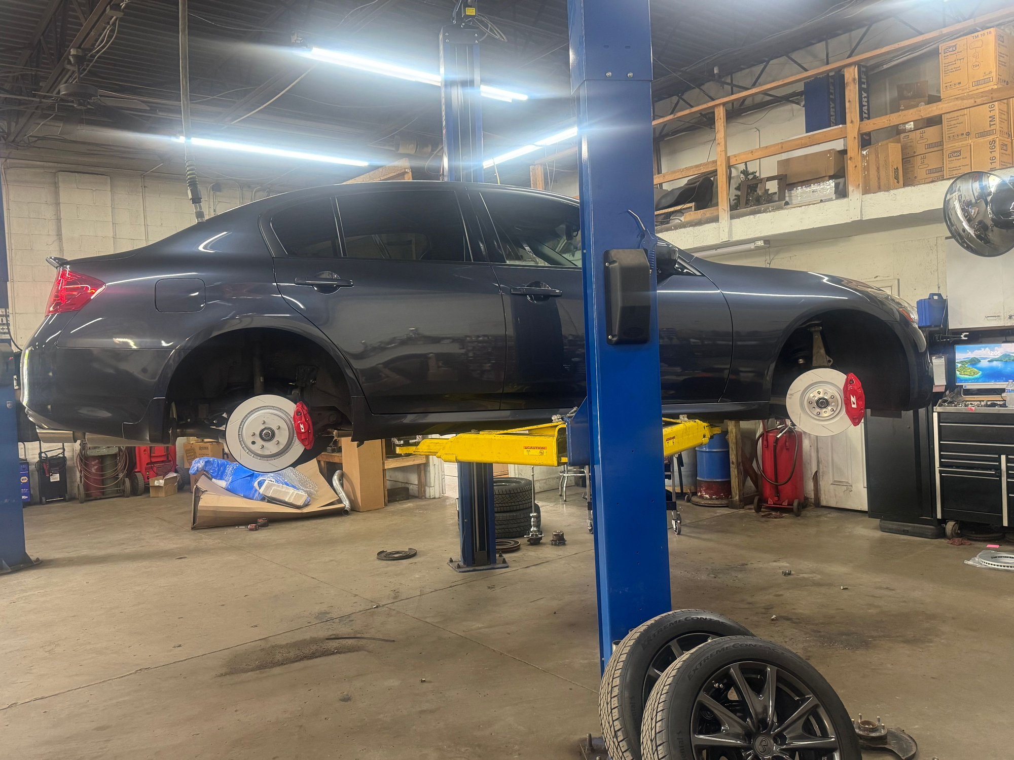

Confirming Z1 brakes will fit 18x7.5” front wheels! Phew!
Old Jun 5, 2025 | 08:43 AM
  #10355
Posts: 19,859
Likes: 5,149
The Z1 calipers are Akebono, painted red and screen printed (decaled?) with the Z1 logo, but still OEM.
And I'm assuming your 18x7 wheels are also OEM sport wheels for the Sedan.
So yeah, shouldn't be any question about fitment.

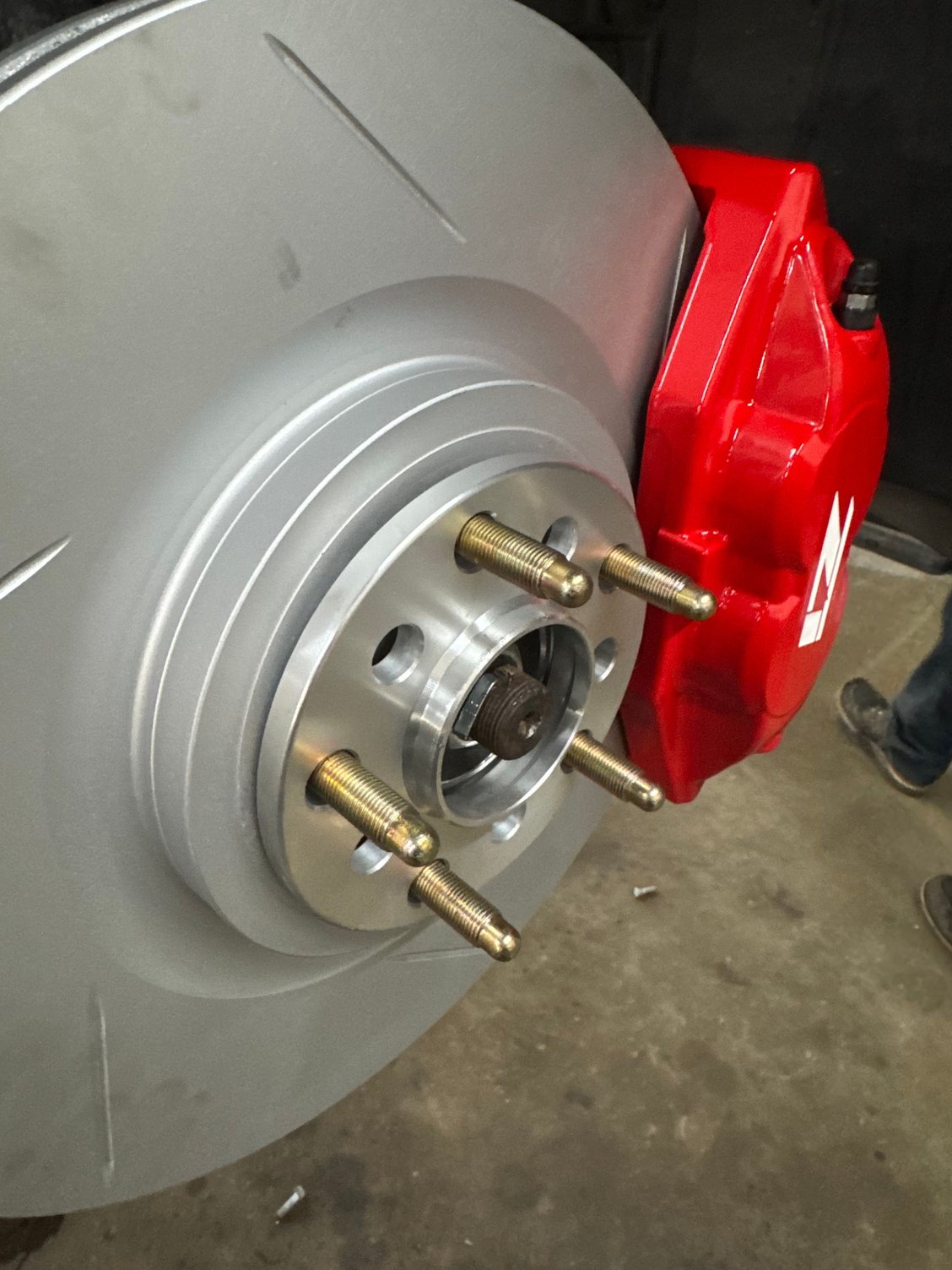

Getting closer.
A couple of comments:
1) Z1 calipers are forged vs Akebono cast and Z1 says that their calipers have “the same size limitations as oem akebono” lawyer speak for they are the exact same size lol
2. The Z1 bolts that came with the 10mm spacers were too long to use OEM lugs. A bit surprised at Z1 here. They had to trim the studs down a bit.
3) The installer suggested I should have done the lines! Not necessarily due to functionality, but to complete the project. He said we will get it next time. Haha.
