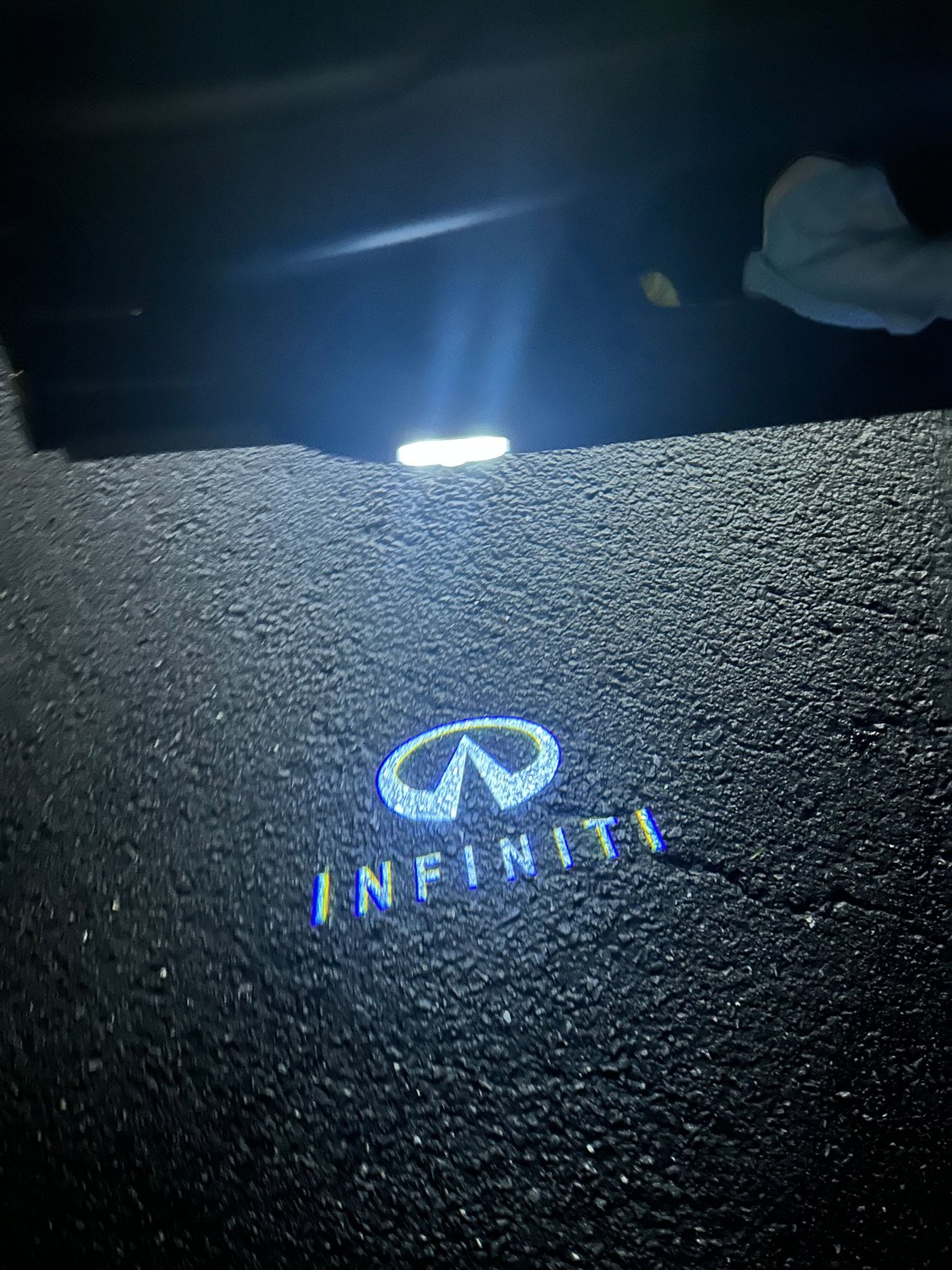

Oh, and since this is “my son’s car”, he got excited and ordered these 😁. I think they were like 24$ on Amazon for FOUR lights! I also swapped out the reverse lights for white leds to match everything else and did the aluminum radio and hvac controls and did the Geyon ceramic coating for all of the glass.
Looking to at least get the front half of the car paint corrected and ceramic coated on Monday without sucking up my whole day,
