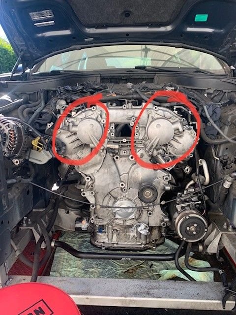

Diving in to Gallery Gasket repair, a story of starts and stops
Not techincally all today, but I did get a little time working on my wife's 09 g37 sedan. Combo of working too many hours at work, having a 5 yo, and giving my wife my Tundra to drive while her car is out of commision is a recipe for procrastinating. Quick question while removing all(maybe) the bolts for the front engine cover, do the cam covers (circled in red) have to be removed or can they stay on the engine cover? Some how i got it in my head that those bolts don't hold the engine cover on just the covers for the cams. Gave the cover a few taps with a deadblow hammer but figured I might need to poll the collective.
Thanks Josh
Do the bolts from these covers have to come out to remove main engine cover?
Thanks Josh
They dont have to come out.
At the same time this gasket just like many will leak over time so it will leak over time.

Thanks, given how far I am tearing this down I will likely replace those gaskets as well but just wanted to check before I try more persuasion to release/split the cover. from the engine. Thanks
