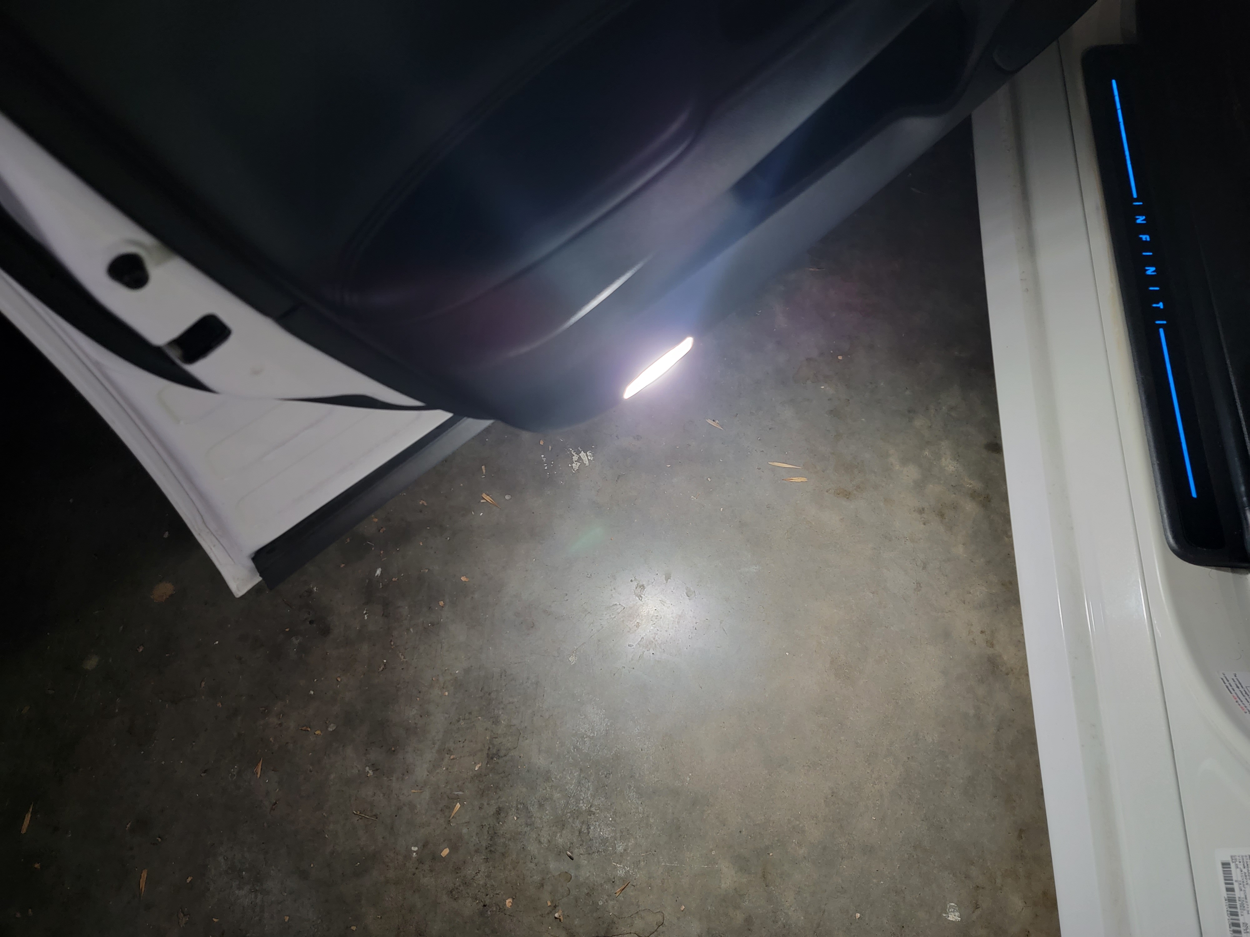

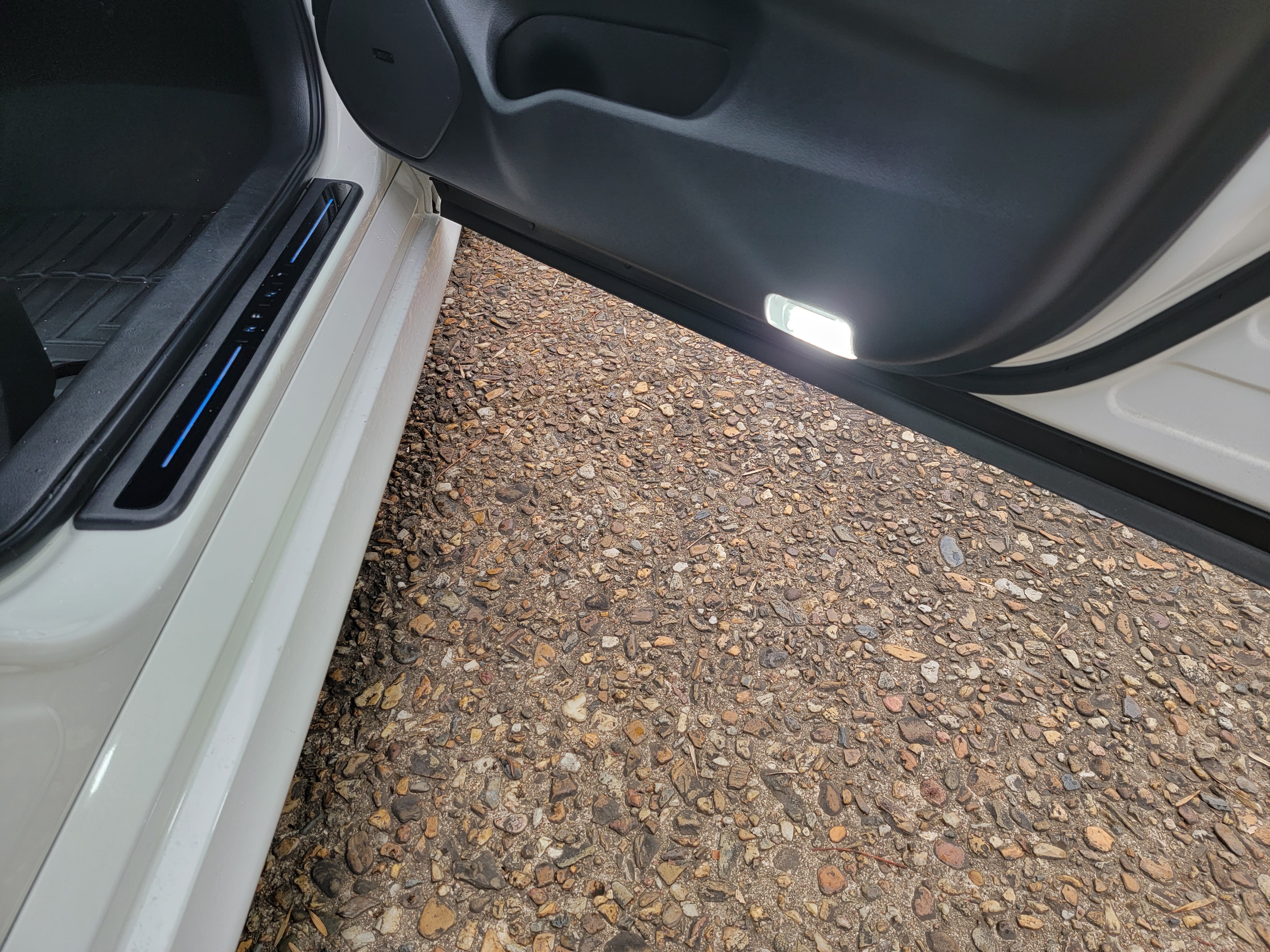

My ghost shadow projectors that came with the car went bad so I replaced them with regular lights.
