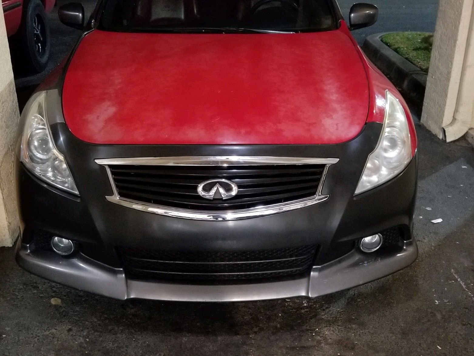

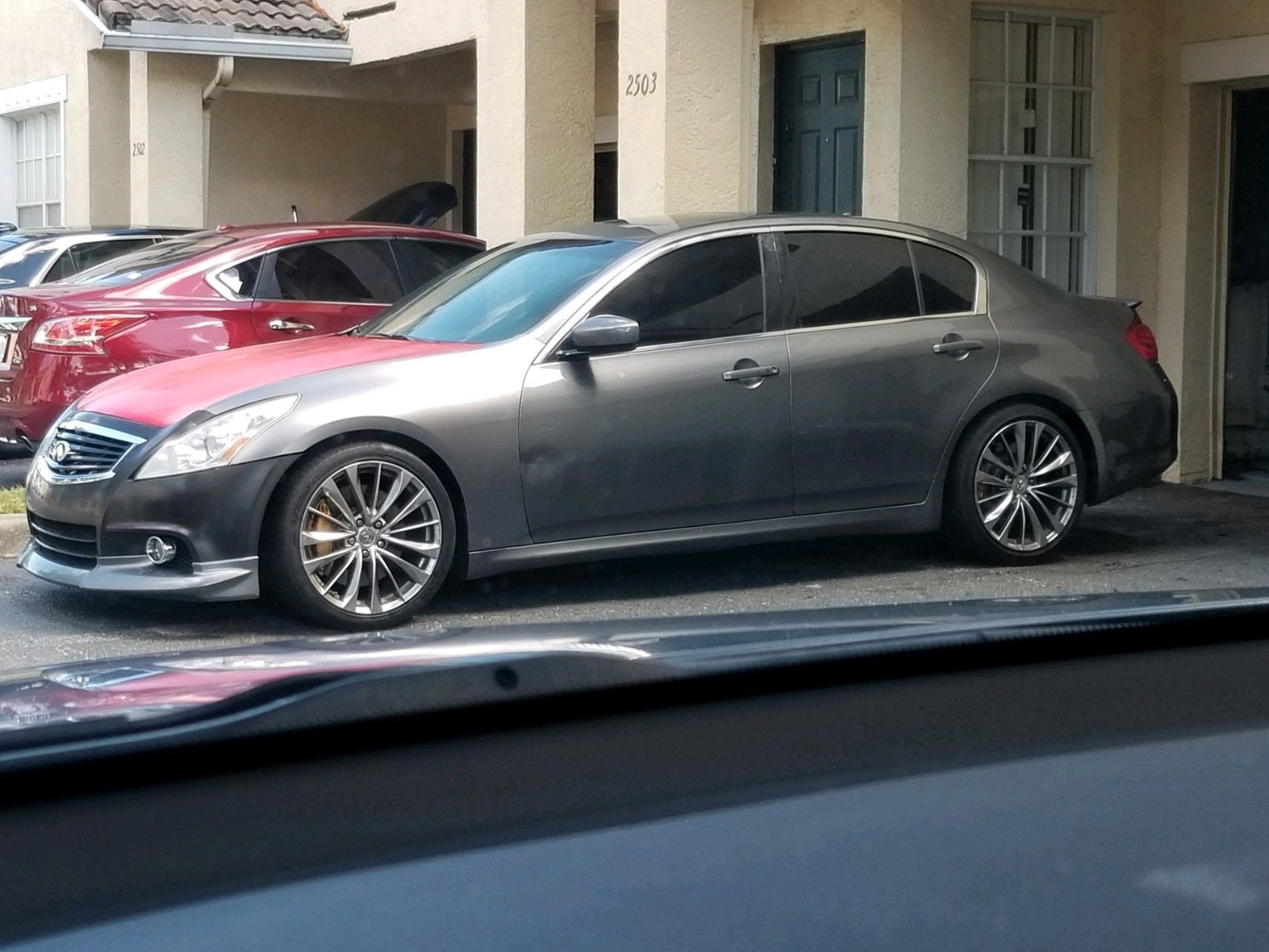

Appreciate the kind words guys
Here's some additional progress:
The car is back on the road, I have a small coolant leak one of my coolant bypass.
Need the crash bar foam to bring up the bumper a bit.
Changing all of the tires, alignment and going to try to cut the rotors as well.
On the positive side I found a charcoal gray metallic wrap that offers promising results.
$50 for the hood i think is a fair try to get it all under one color, this will also let me know if I'll be able to handle the whole car in wrap.
We will see.

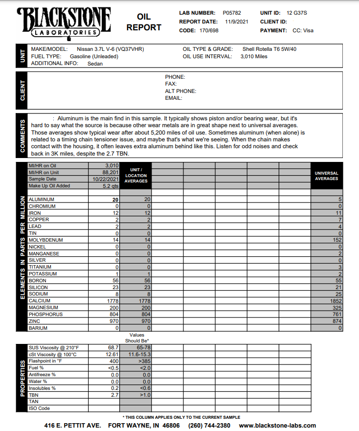

I got my Blackstone Labs report back on my oil.

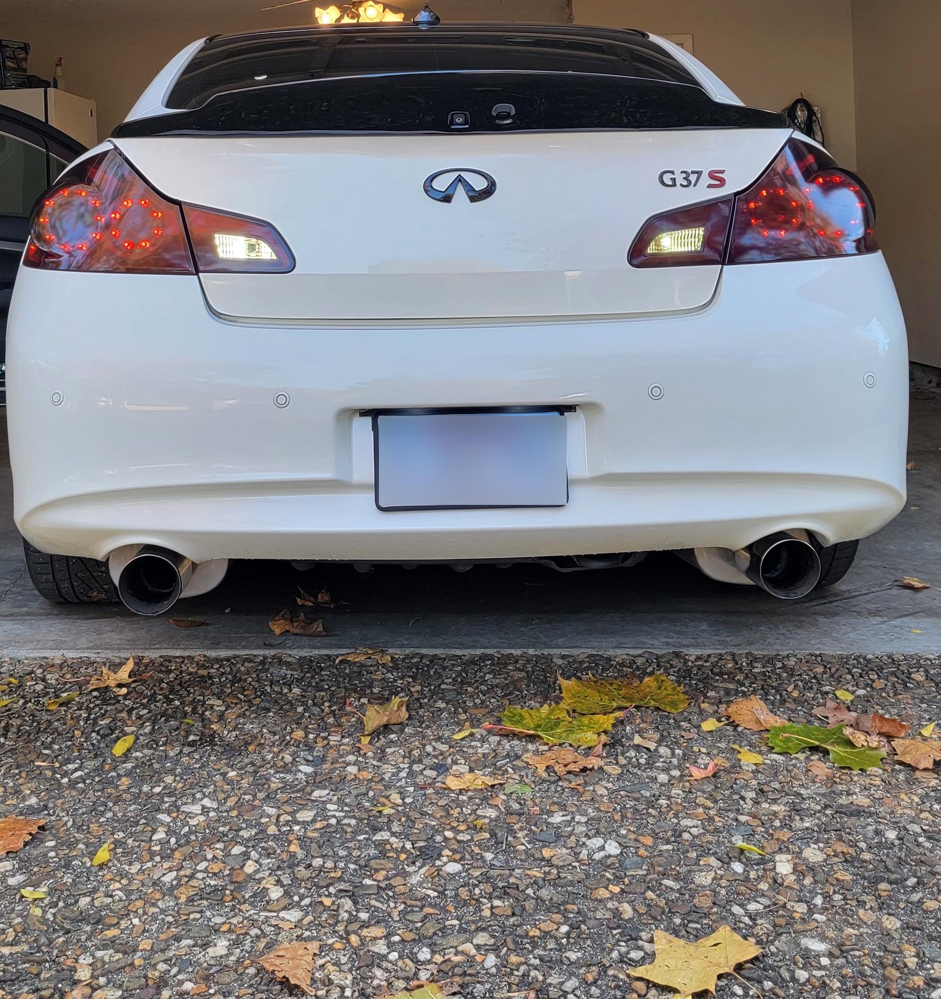

I replaced an Interstate MT-35 with a Diehard Platinum AGM.
Also replaced my XPR50 Diode Dynamics reverse lights with XPR921.
On the left is the new bulb, on the right is the old. There's still tint on the tail lights but soon that will change, but you can see there's a decent difference there.

In time I would like to hear your impressions on the XPR921's. I have been on the fence about trying a pair- even though $90 is rather steep for 2 rarely used bulbs. The reverse lights on the G are practically useless. I have DD's back there now but it's been so long I don't recall which variety.

Extremely useful if you have a backup cam because more light for the sensor of the camera. Plus, it's cool. The idea that people have a very bright indication that you are backing up. The XP50 bulbs also costed $90, so I've spent $180 on reverse lights for this car now, but I am selling the XP50s for a lower price in the classifieds if you wanted to check them out. There isn't a big difference between them and the XPR 921 but there's a very big difference between OEM and the XP50.
