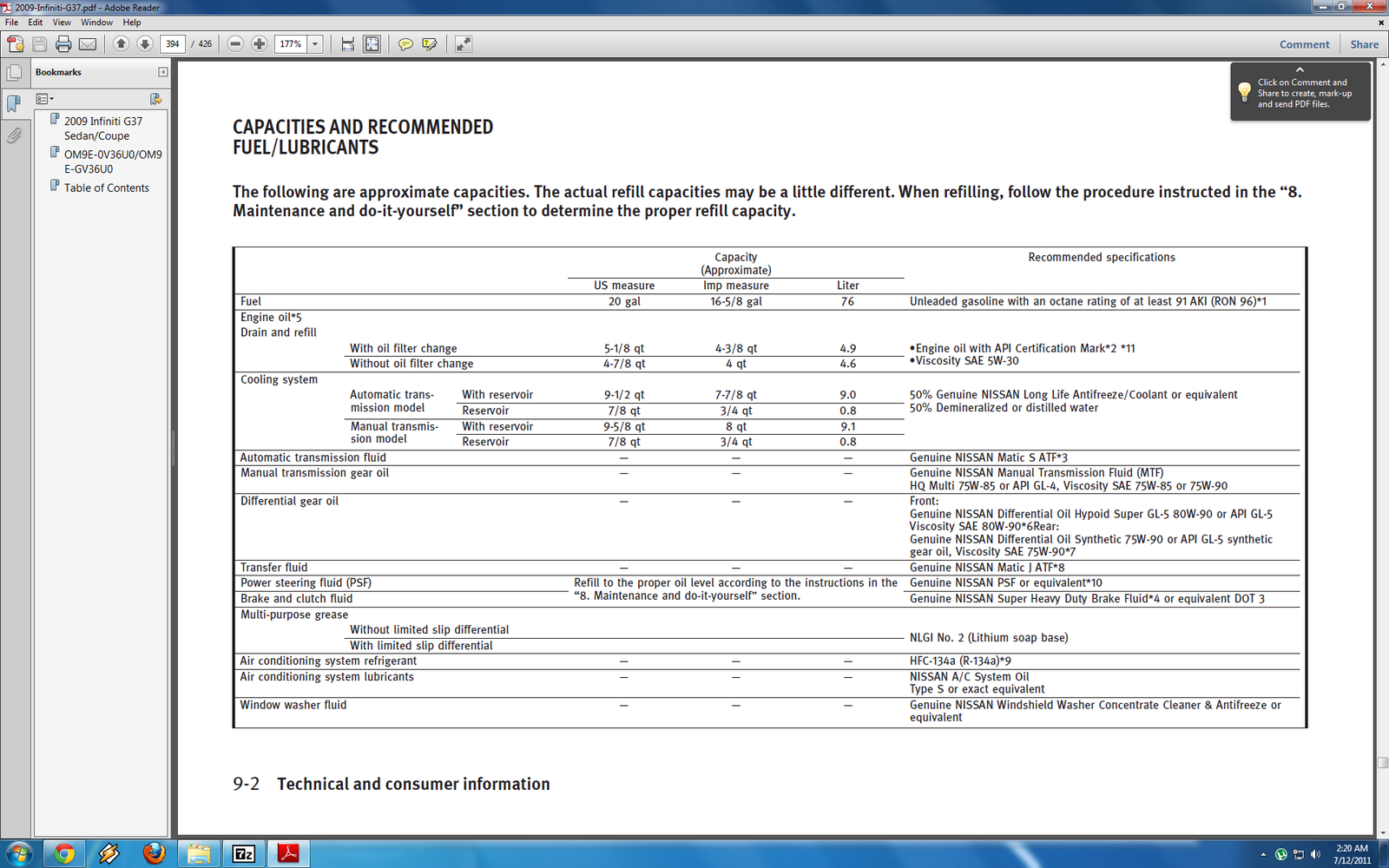

Drivetrain Fluid Change
I will be working with my mechanic next week and will be changing my transmission, transfer case, and front + rear differential fluids. After reviewing the owners manual and various forums posts, I have come up with the following to use for each application:
Transmission:
Redline D6 ATF (satisfies NISSAN Matic S ATF requirement)
Transfer Case:
Redline D4 ATF/Transaxle Fluid (satisfies NISSAN Matic J ATF requirement)
Front/Rear Differential:
Redline 75W90 GL-5 Synthetic Gear Oil
or
Royal Purple Max Gear Oil 80W90
The FSM states for RWD models to use 75W90 and for all models with a front and rear differential (AWD models) to use 80W90. The difference is negligible, I'm sure, however I'm leaning towards the RP Max Gear as they make their oil in 80W90, versus Redline which does NOT make oil to this specification.
For you 7AT guys - if you have changed your front/rear differential fluid, which fluids did you use and why did you choose that?
It looks like I can DIY the front & rear differentials and the transfer case however the trans looks a bit more challenging. Either my mechanic will do this or I will bend over and go to the dealership and force them to change the fluid.
EDIT:
Also, here is some information I have ported from another member's thread through his DIY process.
Capacities:
Amsoil Capacity Information/Limits
Engine, with filter..........5.2 quarts [1]
Cooling System, With AT Initial Fill..........9.6 quarts
AMSOIL Antifreeze and Engine Coolant
Cooling System, With MT Initial Fill..........9.7 quarts
Automatic Transmission, RE7R01A Initial Fill..........Not Specified
Automatic Transmission, Total Fill
7 speed RE7R01A..........9.8 quarts
Manual Transmission, FS6R31A..........6 pints
Differential, Front..........1.3 pints
Differential, Rear..........3 pints
Transfer Case, ..........2.2 pints
(just incase link doesnt work, 1 quart = 2 pints)
Picture of FSM Fluid Specifications:
