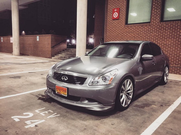

Finally made all of my adjustments and I'm beyond satisfied with the result. Only thing is I'm maxed out in terms of toe adjustment, so in order to reduce my rear camber I need additional toe adjustment (adjusting toe affects your camber and vice versa). I may get toe arms in the future but for now I don't think -3 is that bad. Here's a list of all my specs. Hope this helps!
  • Staggered 19" coupe wheels (19x8.5 F 19x9 R)
  • 245/40/19 tires all around
  • Ksport true type coilovers
  • SPC front & rear camber kits
  • 20mm front & 15mm rear spacers
  • Front camber: -1 degrees
  • Rear camber: -3 degrees
As far as the drop goes, I'm about 25.8" from the ground on my front fenders. I didn't measure the rear but I assume it's something similar.

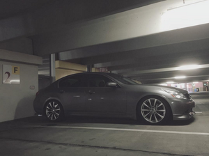

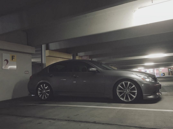

Have any better pics? I should be picking up a set of these wheels tomorrow.
Here's a few, hope this helps!
That looks good!
That is -3 camber out back? What is your reasoning for that? I see you're running SPC front and rear camber kits, but what about the SPC toe bolts? Looks like you'd have room to even up the camber even with the 15mm spacers.
I want to run these wheels, but tire wear is my priority. This thing is my daily. I don't want to have to keep buying 19" tires every year.

Originally Posted by jfisher
That looks good!
My alignment tech advised against drilling a larger hole for the SPC toe bolts because he said it'd compromise the subframe. I said I'd get toe arms sometime down the road (I have true type coils so I can use toe arms). Still haven't gotten them LOL. This is my daily too, but -3 ain't so bad.
Old Jan 7, 2016 | 12:48 PM
  #733
Posts: 19,859
Likes: 5,150
My mechanic didn't even hesitate.
And my Alignment Tech was a 30-year Sr. Tech at my dealership. He thought it was fine.
Maybe. It's a subjective thing.
Personally, I feel that when wheels tilt deeper than -2.5*, it becomes very noticeable on the G Sedan. However if that's the look you want, then winning!
