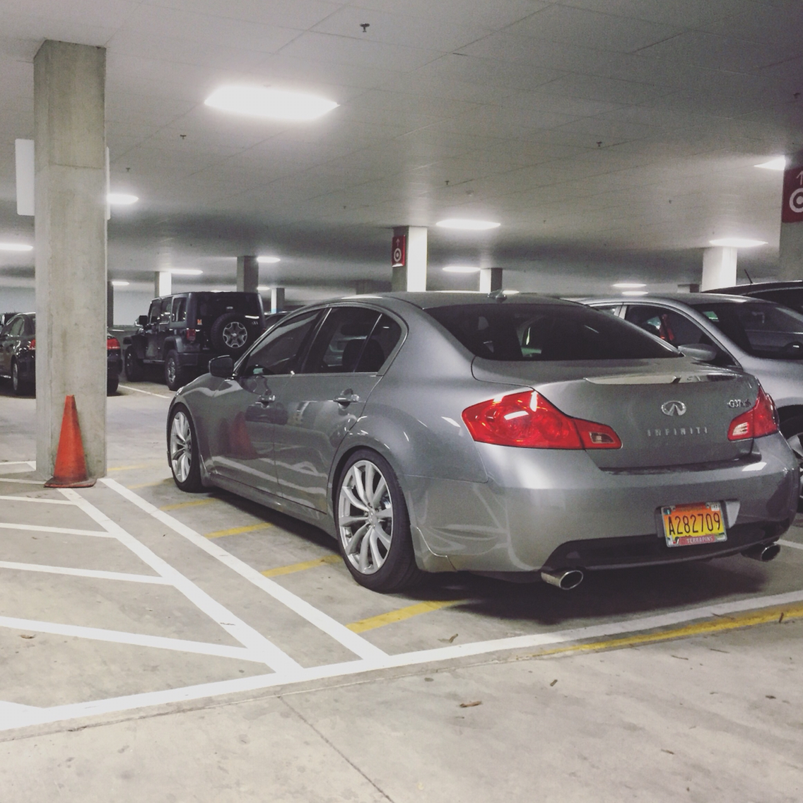

I fan 20mm front and 15mm rear on my AWD. It was a staggered set, thus larger spacers in the front to match with the rear in overall offset.
