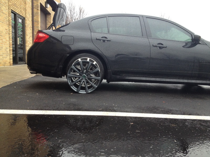

My G sedan goin HAM on some 19" coupes.

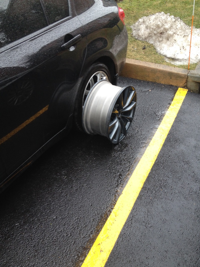

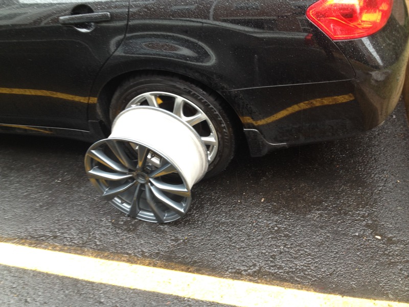

Well i may have messed up BIG time!
just got my Coupe 19" painted and the painter just called stating one wheel looked odd..
dont know how i missed this but they are stamped F 19x8.5J and the rear are different
19x9J and the other 19x9J30...
when i got them i saw that they were staggered. but somehow the 30 didnt register with me.. urg... what to do...
edit: and i have 2 pairs of 20mm spacers coming in..
Old Mar 19, 2015 | 04:31 PM
  #479
Likes: 4,952
So one of your rear wheels is a convertible wheel offset and the other three are regular coupe offsets? Tough spot if that's the case since having the wheels repainted would make returning them difficult if not impossible
if the wheels have yet to be painted you should be able to get it corrected through the vendor, assuming you bought them new that is.
If not I suppose you could just use 3 of your 4 spacers and just be a few mm off w/ that one rim.
G/L
