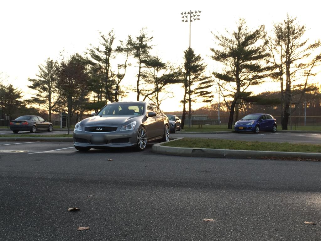

I have 19x9, fronts are off a coupe rears and rears are off a vert rear set. 25mm front spacers and 20mm rear spacers:

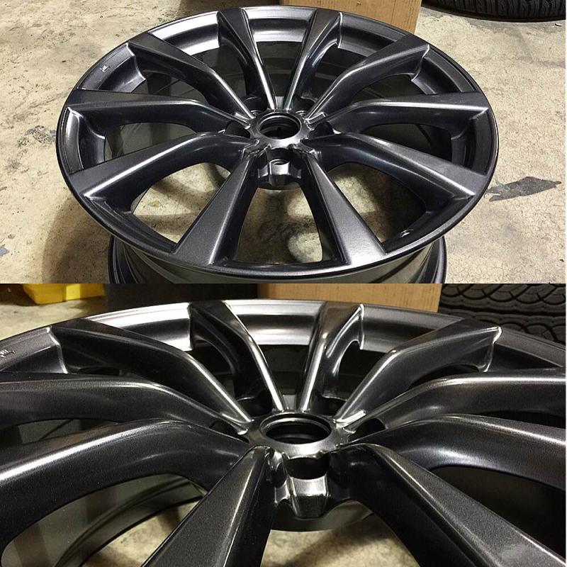

Finally got my set of wheels refinished in gunmetal grey, hoping to get them on sooner than later, but feel like it won't be until March or so

  #430
Likes: 4,952
Looks like a nice set there STown, perfect shade IMO.
I have a swift lowered X sedan on 19x8.5 w/ 47 offset & 245/40 tires and have decided on same spacer setup as you - 25mm front and 20mm rear... do you have any issues with rubbing? Are you running H&R DRM or DRS spacers? Any concerns with the spacers so far?
I was thinking of going with 255/40 when I get new tires since the spacers should give extra space to fit them...
Old Jan 25, 2015 | 01:54 AM
  #432
fastlane45's Avatar
fastlane45
Joined: Oct 2009
Posts: 322
Likes: 14
From: NY
No rubbing whatsoever in the 3.5 months I've had them on so far.. tire specs are 245/45. I'm running H&R DRM spacers with no issues
