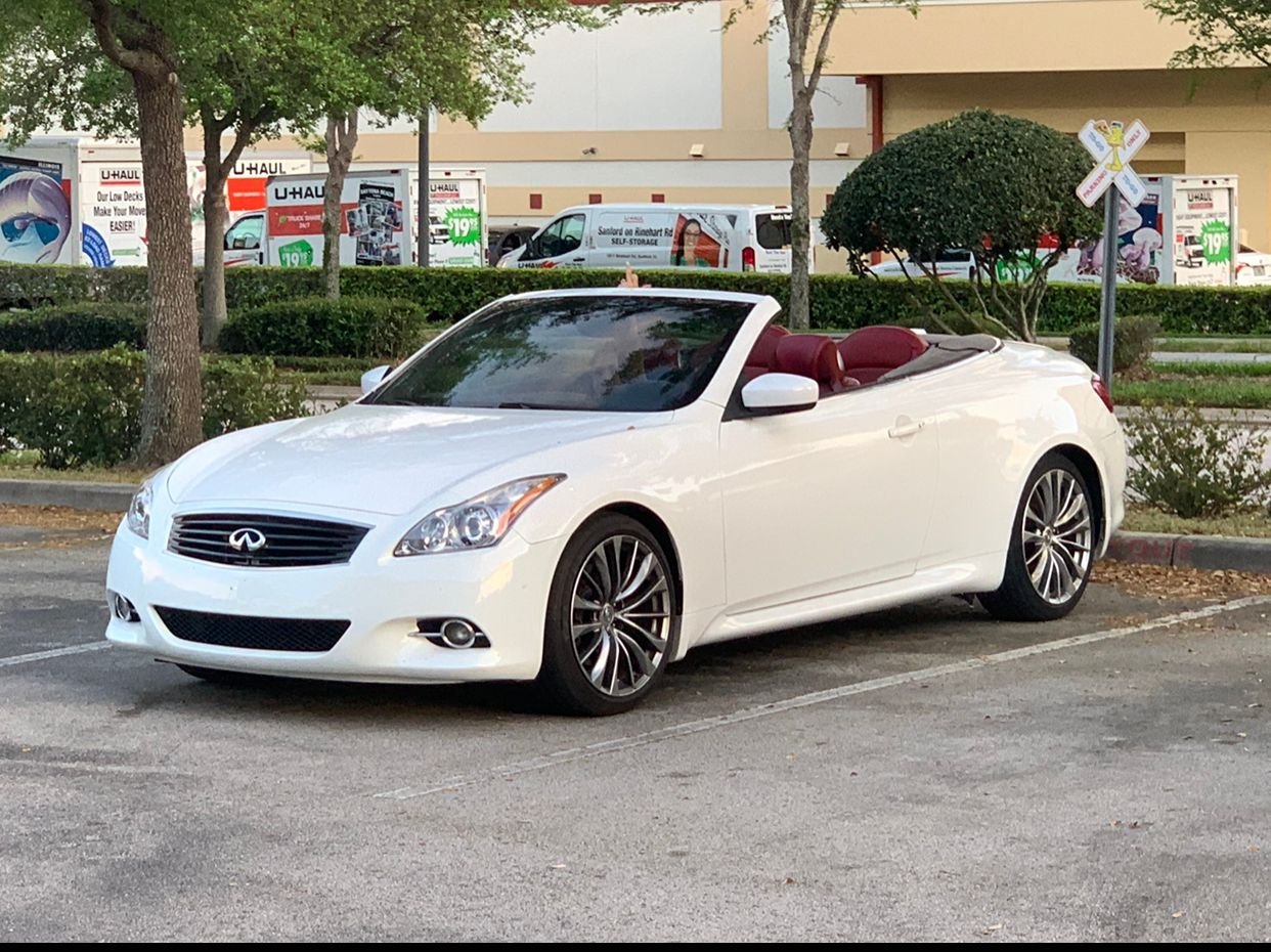

Trying to see or download this link.
Originally Posted by rmw00
YES, YES, YES... Finally figured out how to add paddle shifters to my 2008 G37 Journey Coupe. I'll post some pictures when I get time. You have to get a couple of connector contacts from your dealer. Insert them in connector M66 behind the dash and make your own harness. It does require soldering etc. Mine works great!
HELP PLEASE. I have G37 2009 convertible without NAV (no factory pre wire for paddles) that I am converting to a mix of IPL/Sport model. The only part I am missing is this pre wire diagram so can DYI.
I have a flicker account, but post can’t be found.
Please help!!!!!

Ospinca, I am so jealous....such a beauty....
