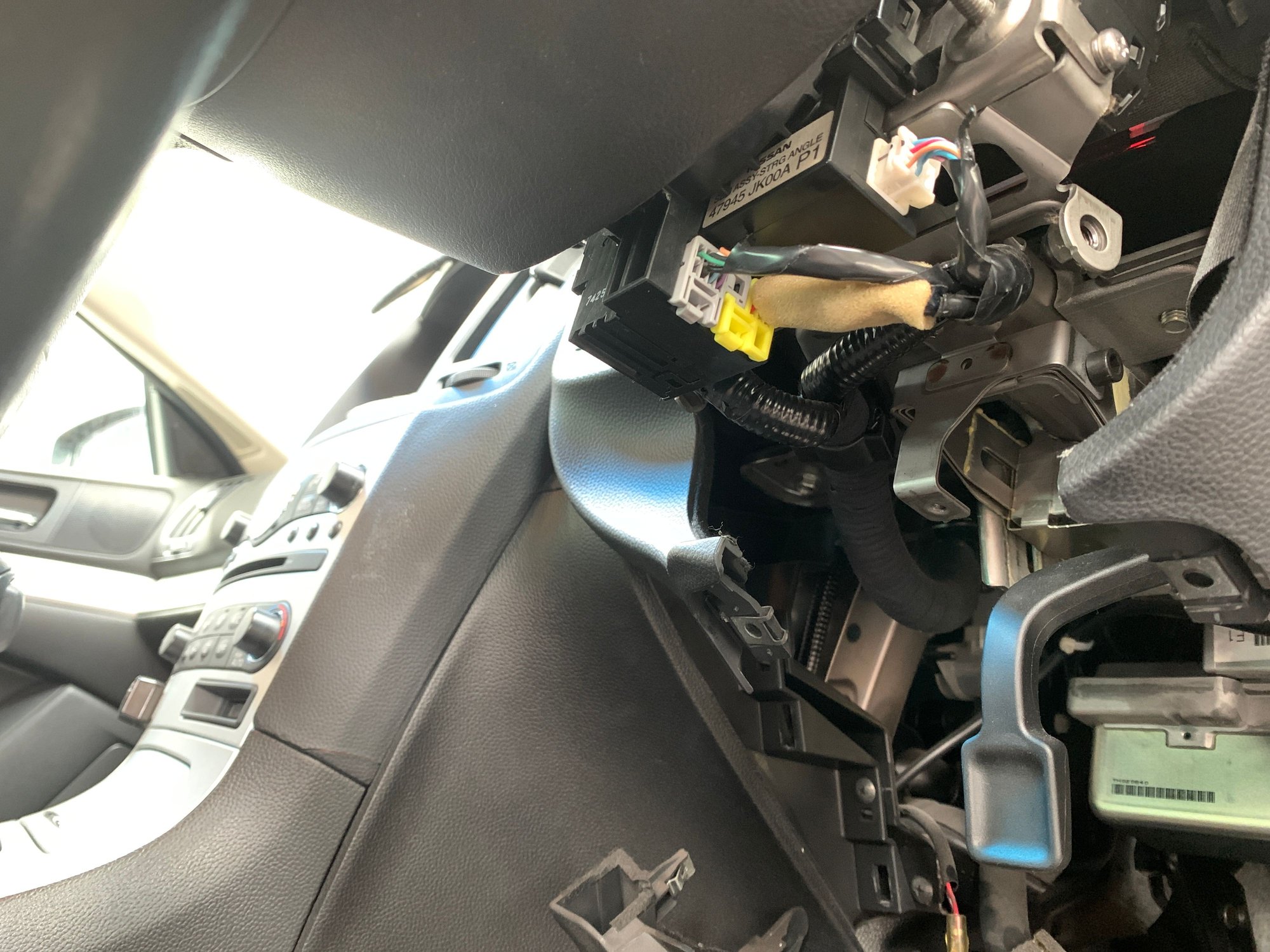

Hi guys,
I’m in Australia so I have got my 370gt imported from Japan recently. I have done some research about the paddle shifter installation and figured out it no one has figured out if they can actually wire the paddle shifter if there is not pre-wired and taped down the steering wheel, or they did but didn’t post on the internet.
So can you actually wire it yourself? If so how hard can it be?
thank you.
I have opened up the interior but did not found the wire

Assuming your car has "Manual Mode" on the floor shifter, adding paddle shifters to a car that is not pre-wired can be done but you will have to run 3 wires from the steering column to the AC Amplifier that is mounted in the center part of your dashboard. If memory serves, there are 2 signal wires and 1 ground (earth) wire. This also assumes that you are able to source a set of paddle shifters preferably with the wire connectors (pigtails) attached (just makes it easier to splice).
Tomorrow I will check the FSM for you and advise accordingly. However, being that your car is, technically, JDM, the wiring might be different than our USDM manuals. Will see what I can find out for you.

What part do you not understand? Everything in this thread shows you what needs to be done. The paddles Nissan uses (whether you have the column or wheel mounted type like I have) are only SPNO (Singe Pole, Normally Open) momentary switches.
Each paddle has a 2-wire connector: one (1) wire goes to A GOOD ground while the other wire goes to the appropriate slot on the AC Amp. When you pull the paddle, the switch closes and this completed circuit sends a GROUND signal to the amp which then changes the gear. None of this is rocket science.

Tapping into the "Manual Mode" circuits (slots 5 & 25 at the amp) likely will not work in this case as there is no GROUND source to complete the initial circuit. Even if the shifter was permanently in "Manual Mode" the paddles still need a VERIFIED ground.
Others have added paddles using the above method with no issues. The hardest part is sourcing the wires with the female terminals that can inserted into the connectors.
