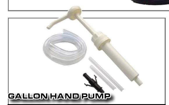

Hello, I wanted to do this analysis for my first batch of factory oil but the cool guys at Infiniti of Montclair mustve forgotten even though I had told them to fill the container GRRR.
Anyway I bought this pump so I can do it myself next time:
The hose is about 24 inches long.
Is it long enough to grab some oil from the dipstick area? Thanks.
Old May 18, 2010 | 12:32 AM
  #118
SM_Shadowman's Avatar
SM_Shadowman
Joined: Feb 2010
Posts: 797
Give it a try it and find out!
