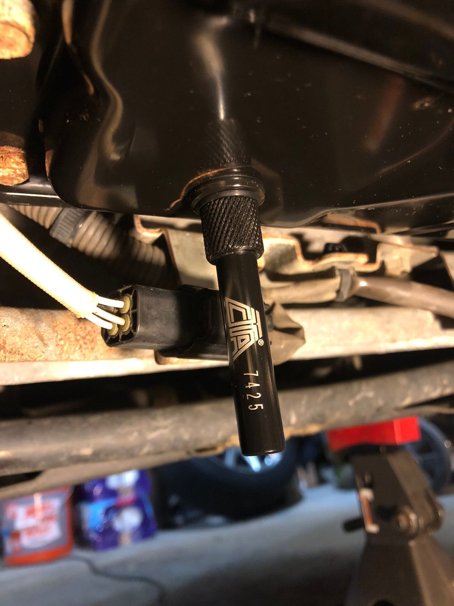

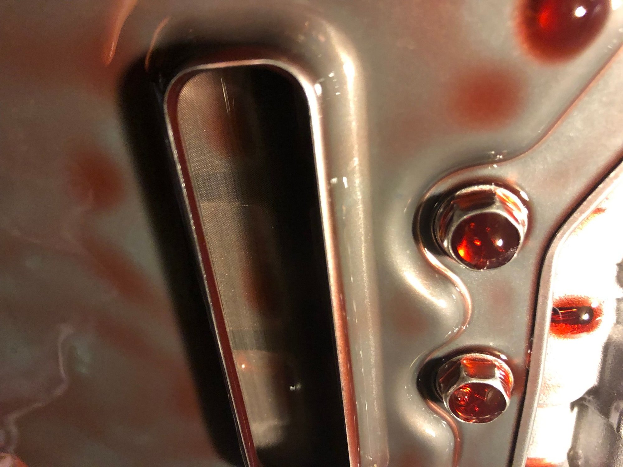

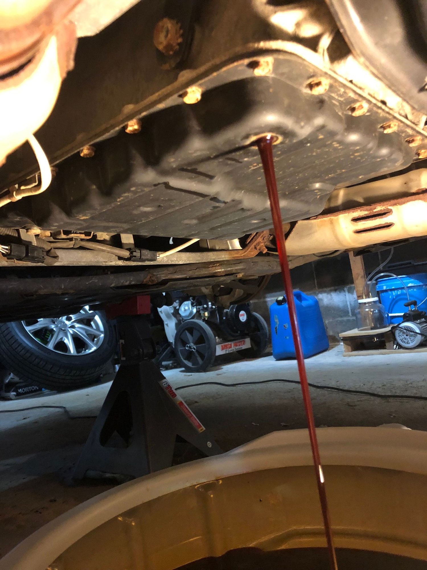

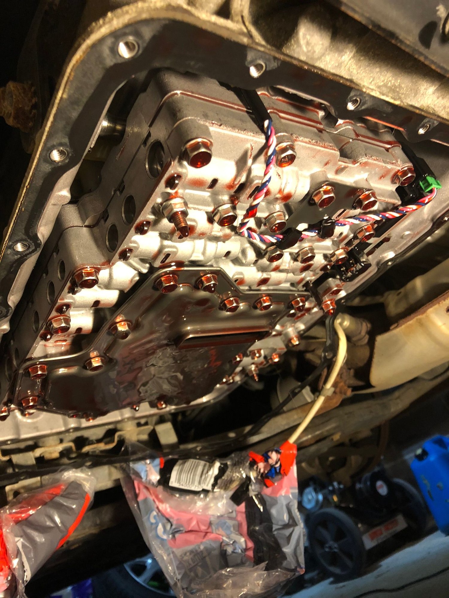

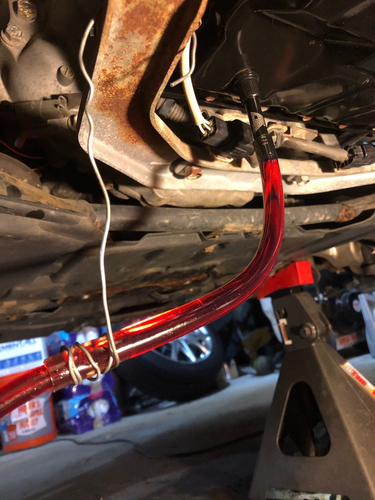

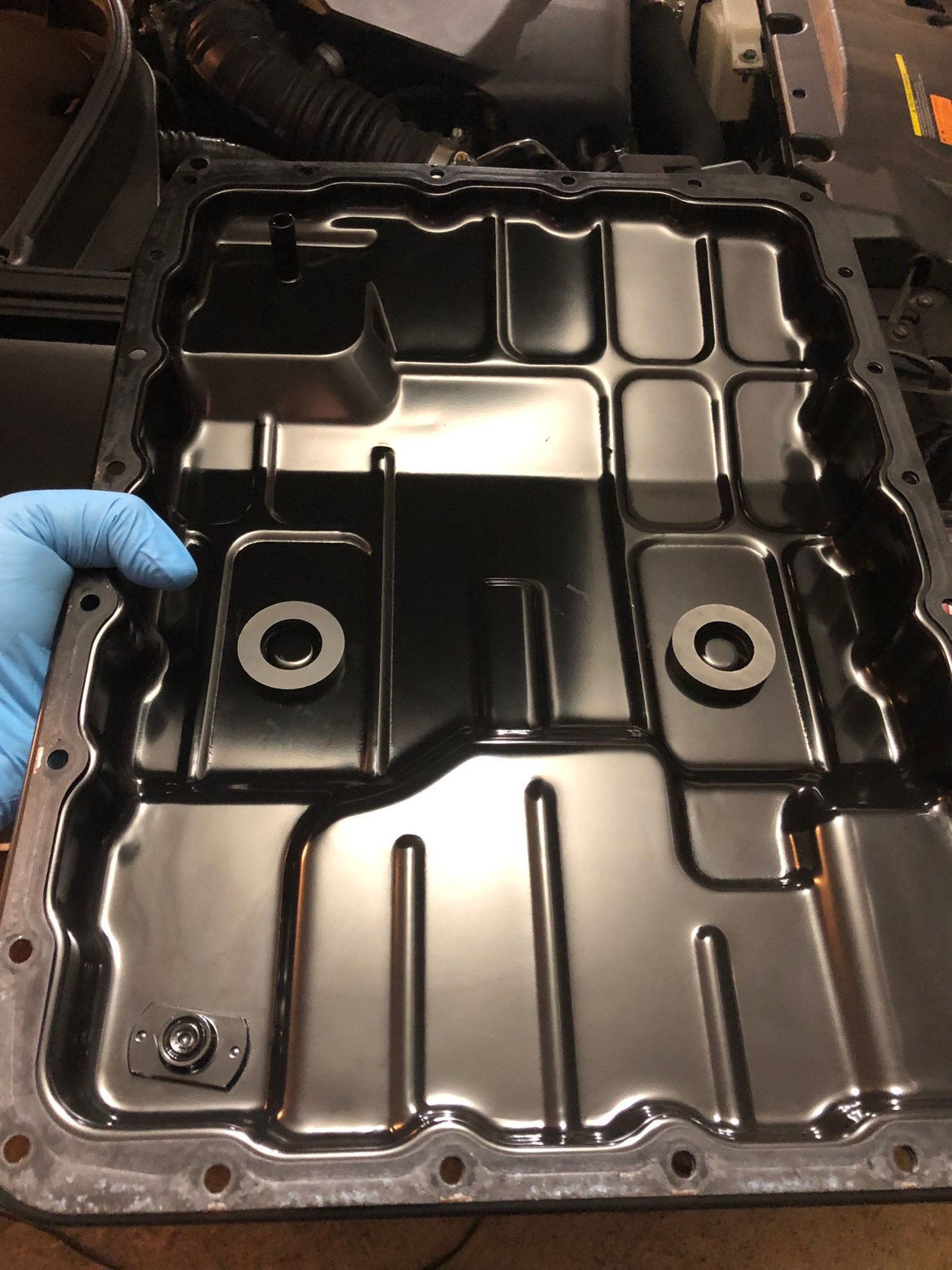

I can't believe it has been 10 years since I made the original post. I still own the vehicle and the transmission has been working great. Recently I've realized that it has been over 56K miles and over 8 years since I did my last transmission oil change. I thought it wouldn't hurt to do it again. Last time I put Pennzoil Platinum LV Multi-Vehicle ATF in. This time I went with Valvoline MaxLife Multi-Vehicle ATF. No particular reason, just whatever is readily available at the local Walmart and has Matic-S mentioned on the back label. Took me noticeably quicker than before to get it done. Here are the steps I followed,
  • Drained ATF (by that time car was sitting for 8 hrs after the last drive, 6 quarts came out)
  • Removed ATF oil pan, cleaned it well and installed it back after wiping the transmission oil filter clean. Torqued transmission oil pan small bolts to 72 INCH-pounds.
  • Pumped 6.5 quarts of ATF in (used a CTA 7425 tool this time)
  • Started the car and cycled from Park to R, N, D several times, keeping in each position for 5 to 10 seconds (had the fill hose with the pump still connected to the transmission via the CTA tool; simply used vise-grips on the hose to prevent any flow)
  • Drained ATF and torqued the drain plug to 25 foot-pounds (this time only 4 quarts came out)
  • Pumped 6 quarts of ATF in.
  • Started the vehicle and cycled through the gears like before.
  • While vehicle is still running, got underneath and removed the CTA tool, allowing excess ATF fluid to start flowing out.
  • Once it started barely dripping, reinstalled the fill hole plug (collected about 2.5 quarts of the excess fluid this way)
  • Stopped the engine. All done.
Here are a few pics had snapped,
