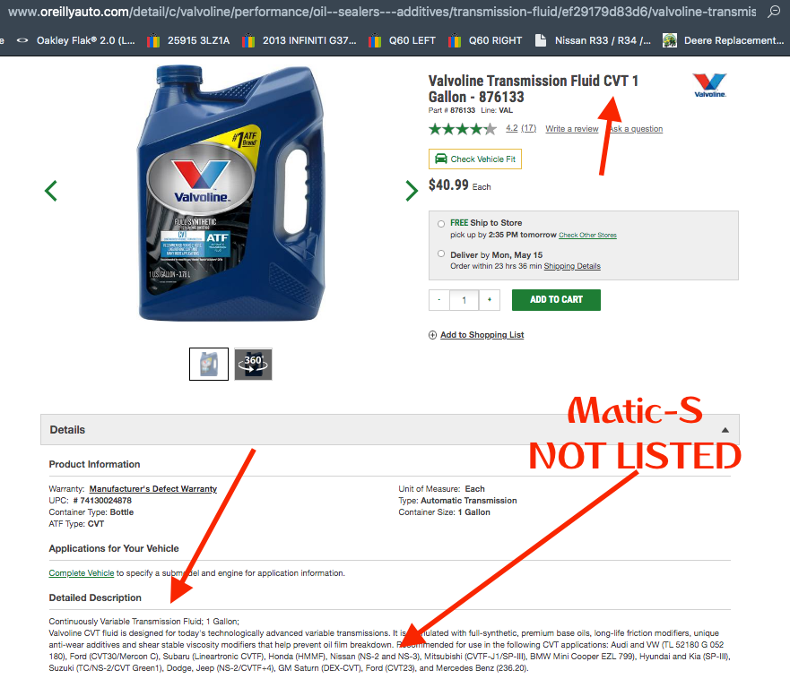

Pretty rude answer considering you must not know what this is: it IS ATF fluid
Valvoline CVT
https://www.oreillyauto.com/detail/c/valvoline/performance/oil--sealers---additives/transmission-fluid/ef29179d83d6/valvoline-transmission-fluid-cvt-1-gallon/val0/876133/v/a/130995/automotive-car-2015-infiniti-q60

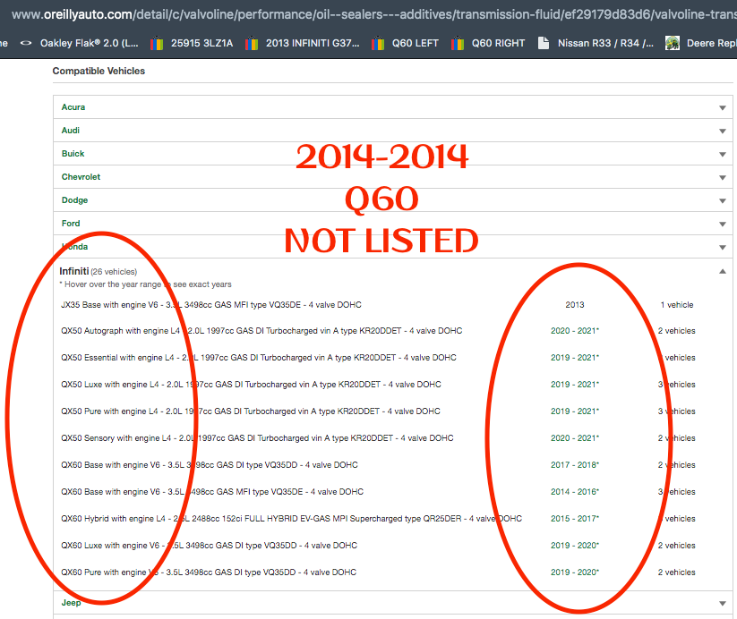

Rude? Hardly. If I was rude, I would have told you to go ahead and use it. In reality, I could care less what fluid you use. But for the sake of other folks reading this thread and to prevent mis-information...
The transmission in your Q60 is a RE7R01A which is a 7-speed FIXED GEAR automatic transmission. It relies on hydraulic pressure to change between gear ratios. It is NOT a CVT (continuously variable transmission) which uses a internal belt-driven pulley system. In this system neither the pulleys nor the belt are fixed thus a infinite number of gear ratios is output based on driver demand. Given this continuous output there are no shifts. Two entirely different transmission systems requiring two entirely different fluid formulations to operate.
Now, if you had read ALL OF the information in the link you provided (instead of looking at the picture) you would have noticed the following:
In your defense, I will acknowledge that many industries classify the CVT as a automatic transmission, which is proper. And, yes, the listing does mention "Automatic Transmission." However, there are two types of auto tranny's: fixed gear and variable. So, yes, it can be confusing "at a glance."
So, NO, the fluid you asked about in the O'Reilly link will not work.
