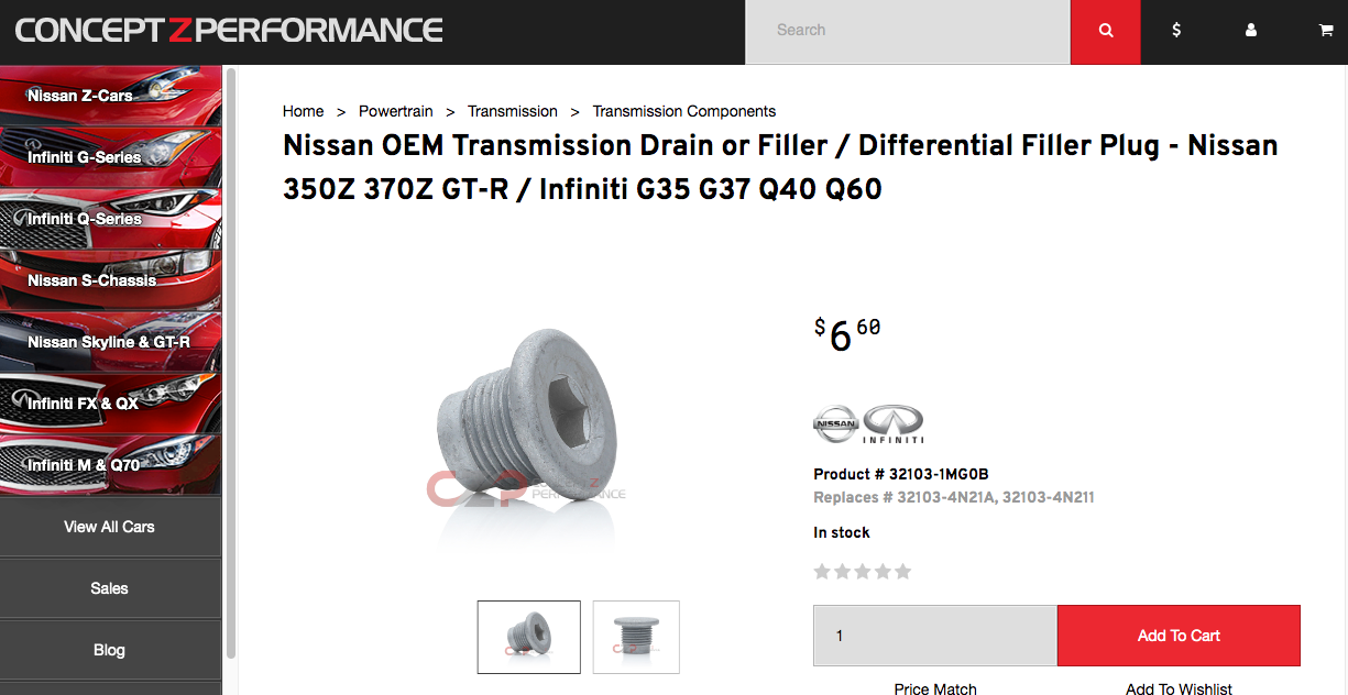

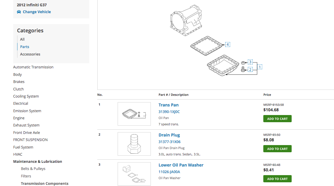

fill plug part #
Does anyone know the fill plug part #. I can't get mine out, I will have to drop the pan and try to get it out. but will need a new one.
thanks,

Here you go... from discountinfinitiparts.com as of 30 October 2022:

From: Baltimore/Annapolis
isn't that the drain plug? I need the other plug where you put the fluid back in!! and I can't find the part even listed or shows on any parts website! it looks more like this:

My bad. Total brain fart there- too much Halloween candy/ Reese cups, perhaps.
That said, the "plug" is universal in that it goes by several different names depending on the part it is used on. It can go by "Trans Drain Plug," "Diff Drain Plug," or "Trans Case Drain Plug-" again, depending on year, model, and usage.
Anyway, here you go- from Concept Z- the part is available from Infiniti but this site had a picture (as of 30 Oct 2022):
Sorry for the confusion...

After searching the whole internet for 6 hours, I think I finally found it.
part # 31361-1XJ0A
Old Oct 30, 2022 | 08:38 PM

Best advice, I would suggest you email discountinfinitiparts.com with your VIN and have them verify which plug you need for the 7AT. They are a actual dealership and offer top-notch customer service. They will tell you exactly what you need.
Good luck!
