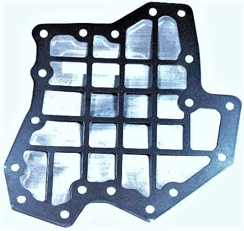

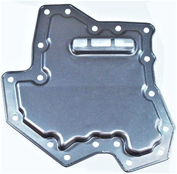

What would be the part for oil transmission filter ? Thank you.
Because I don't know I feel that, one guy got discouraged to change the filter, and seems nobody is changing it ... but common every other car brand youtube video people change the filter when doing a transmission flush. And I can see some kit with pan gasket and filter. (not really easy accessible in europe that's why I'm asking for the exact part number). Thank you.
