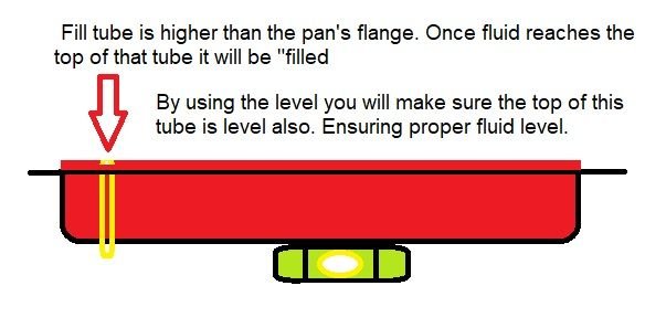

The level will solve all of your guesses. By using the level on the most leveled area of the pan will mean that the internal fill tube will also be leveled, removing the need to put your car on the floor to drain excess.
Also very important, fluid excess needs to be checked on hot fluid while the vehicle is on.

I don’t really understand what abrecos is saying about the level tube, or something , should have quoted it cause I already forgot but I see what your saying bull about the temperature. I have a scanner for the car that tells me the internal temp of the fluid, will be testing that today to see what happens from cold to running. And I intend on having the car level on Jack’s when this is done
Old Dec 16, 2020 | 11:00 AM
  #350
BULL's Avatar
BULL
Moderador
Joined: Jun 2019
Posts: 2,626
Likes: 765
From: South Florida
Hopefully visuals help

All i am saying that there is a welded tube on the fill hole inside the pan and you fill ATF until is start dripping from that hole, make sure your car is leveled,and when is dripping of ATF fluid stops put your plug in and called it done.
