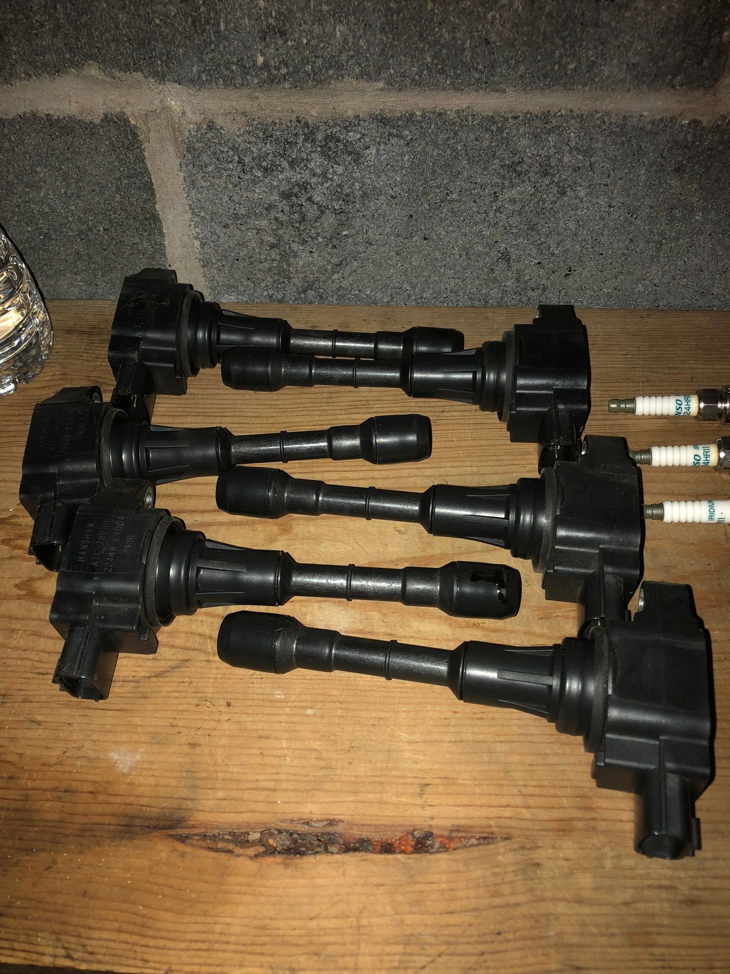

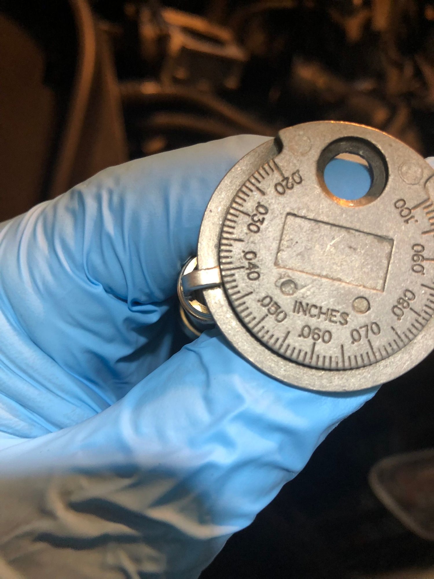

Smile Replaced spark plugs with 50K miles on them

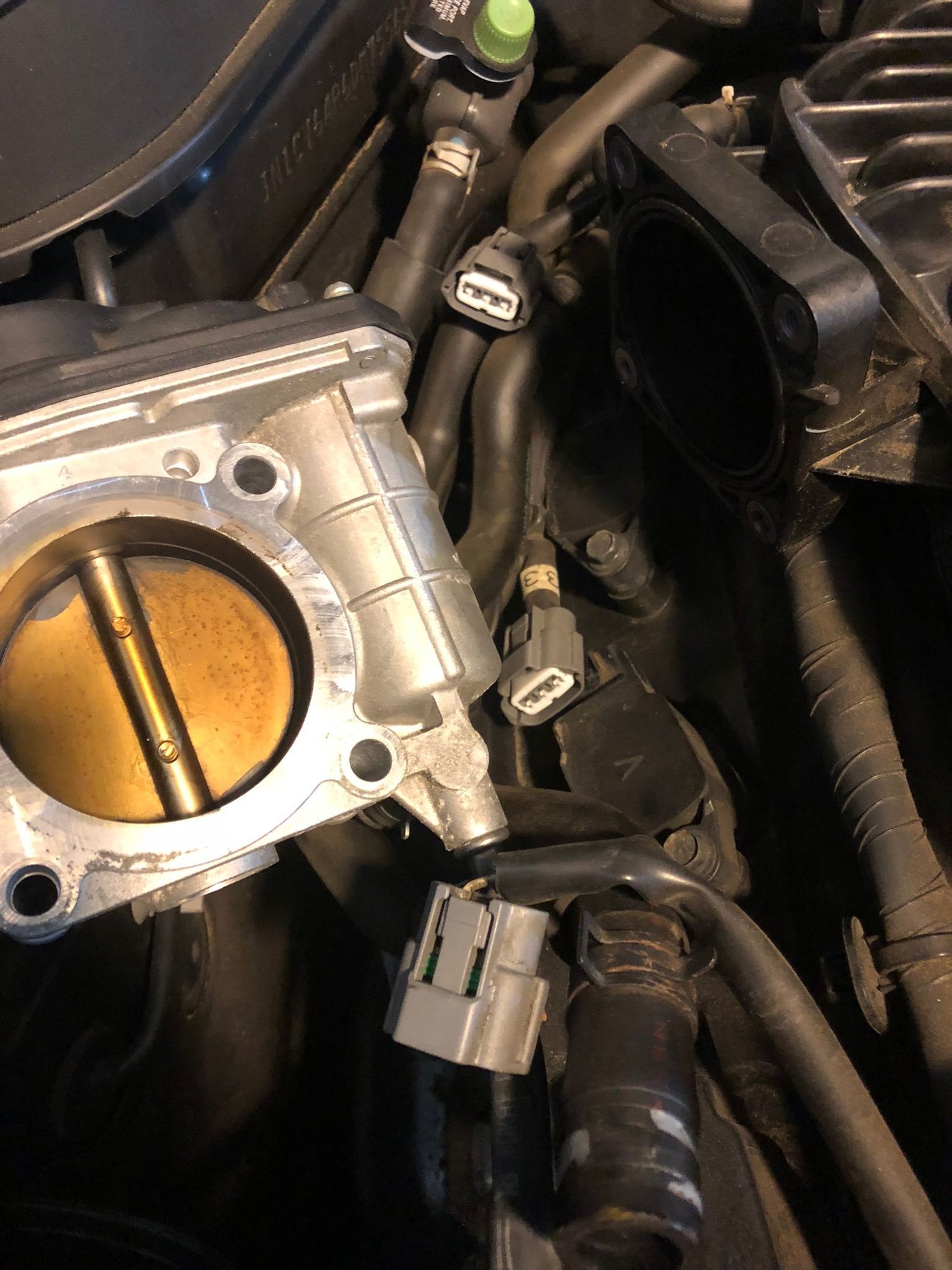

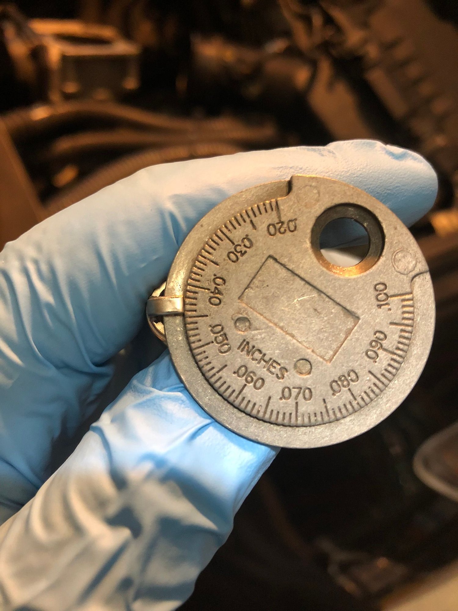

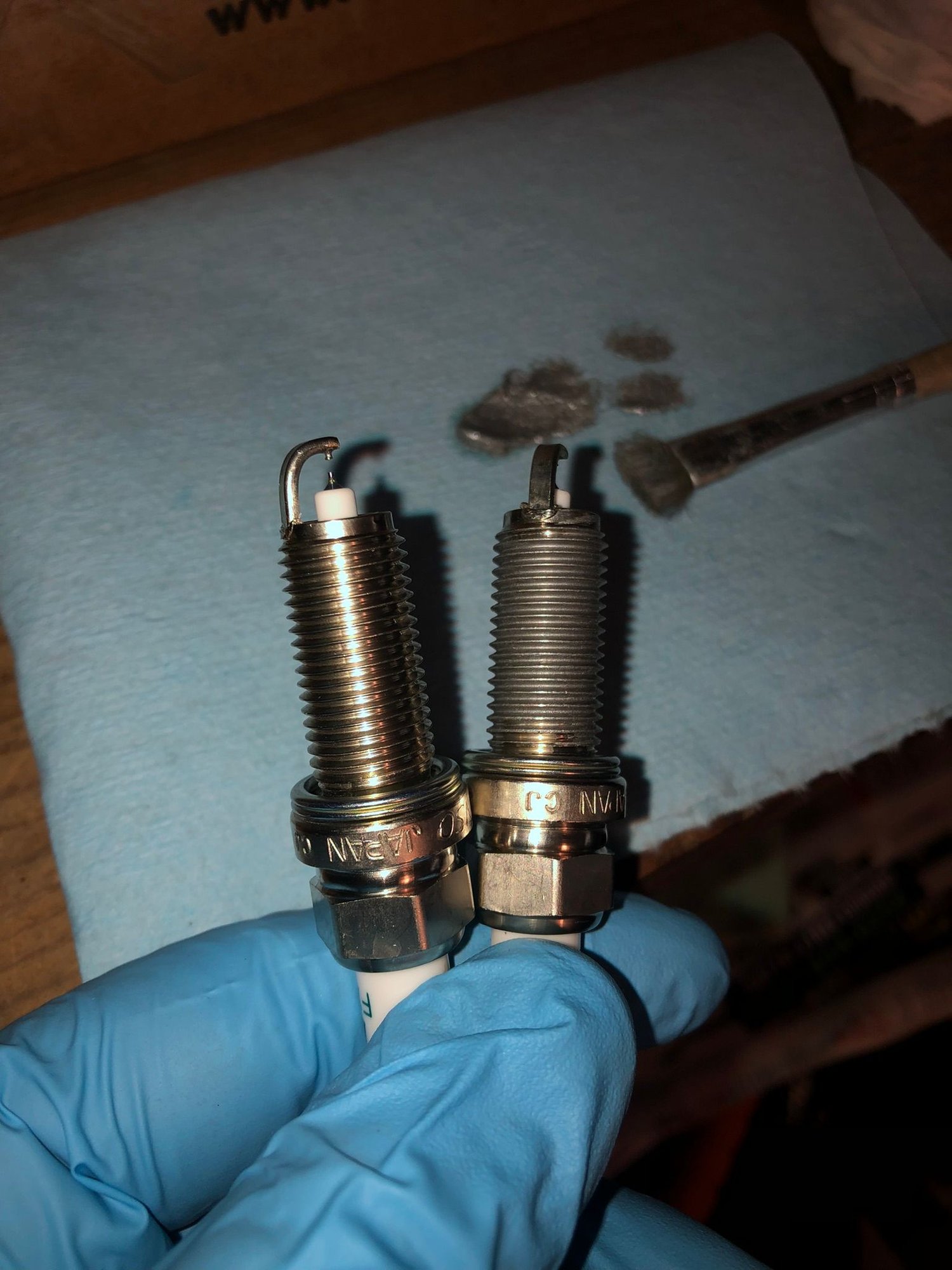

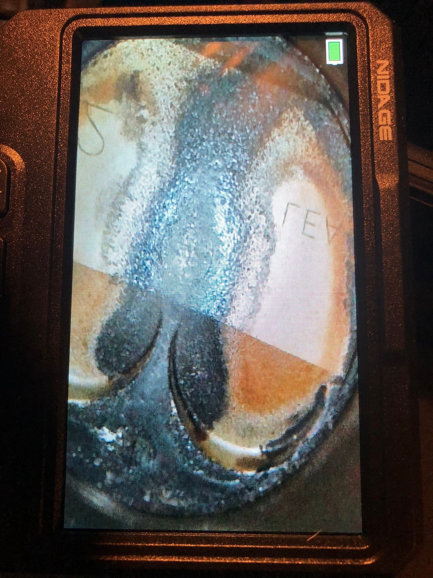

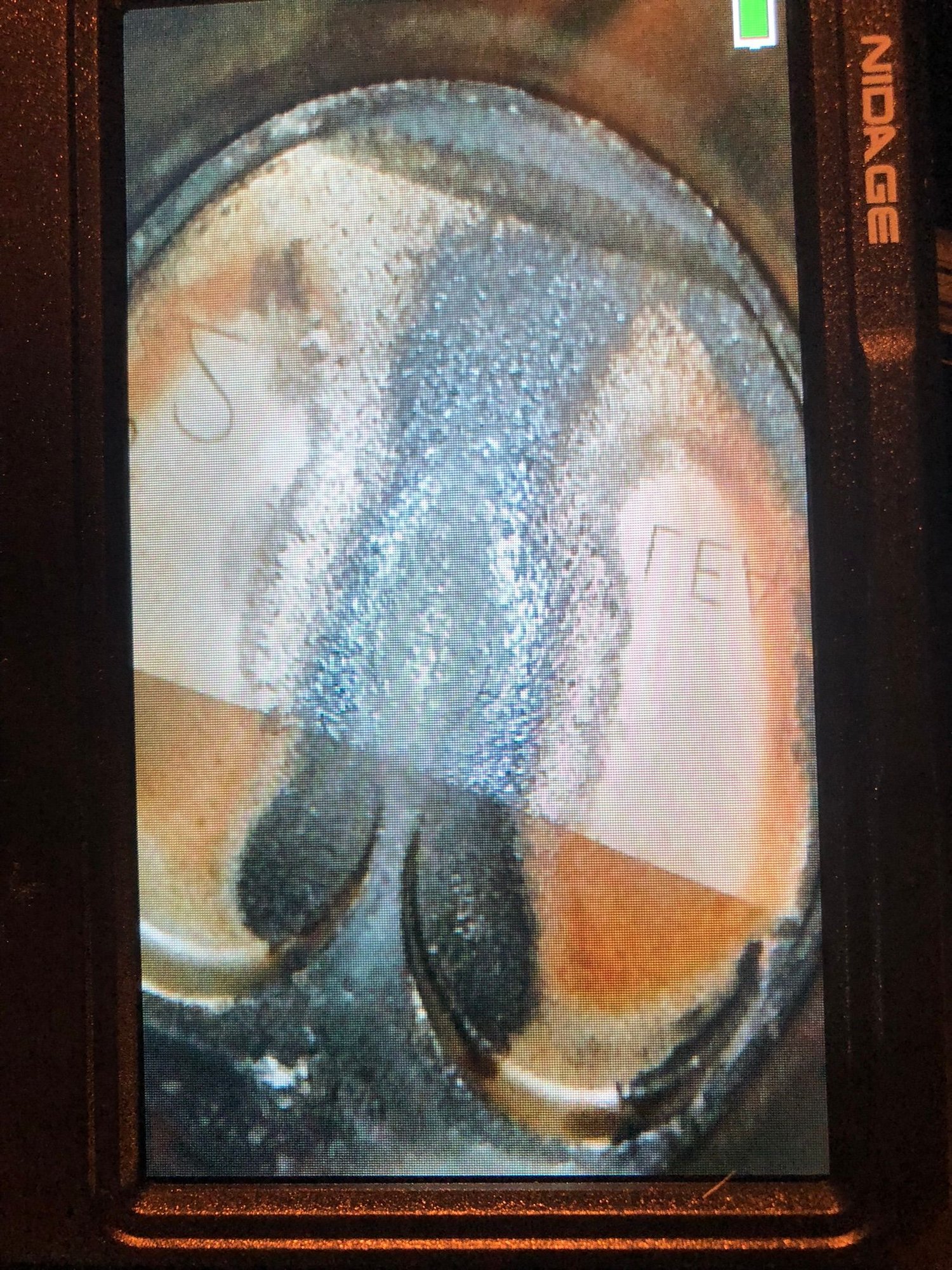

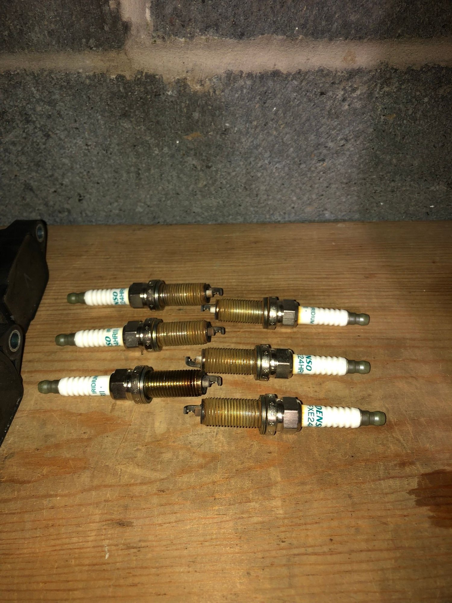

Replaced spark plugs at 97K miles. These were installed at 47K miles, so they had a 50K miles run on them. While unscrewing they were squeaking bad and threads appeared oxidized, so I put a light coat of anti-seize on the new spark plugs. Adjusted the gap to 0.043 inches per owner's manual specification. Added a little bit of dielectric grease at the opening of each spark plug boot. Torqued to 14ft-lbs per FSM. Cleaned throttle bodies and peeked inside the cylinders while at it. The car continues to run great.
Nice. Need to ask Santa for one of these as an endoscope is a cool toy for those with OCD:
Amazon Amazon
We are looking at the bottom of the exhaust/intake valves? Or maybe a set of intake/exhaust as we have two for each.
