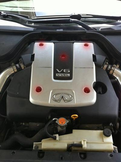

1. Remove engine cover.

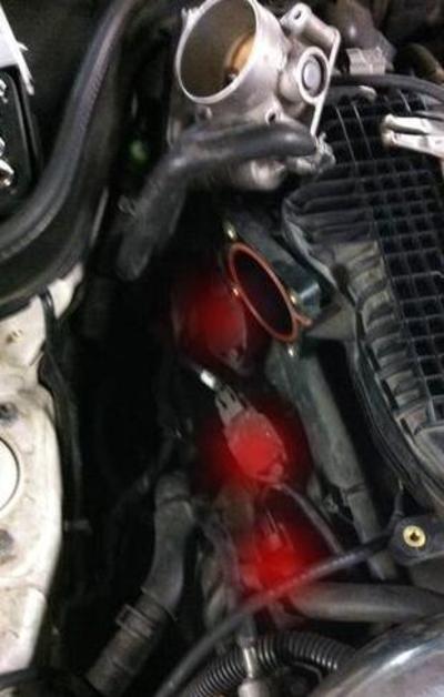

3. Get this line out of the way

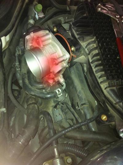

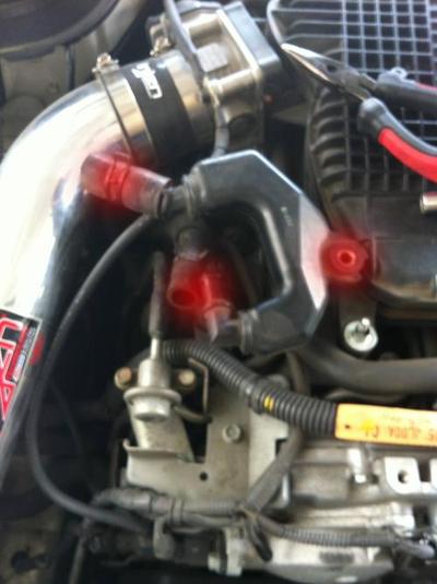

4. Remove the throttle body and the electrical cable (at this step if your throttle body looks dirty you can clean it with some throttle body cleaner).
follow this DIY by Q8y_drifter
https://www.myg37.com/forums/d-i-y-i...le-bodies.html

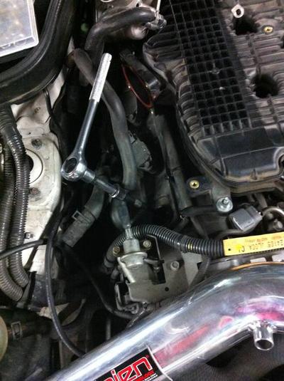

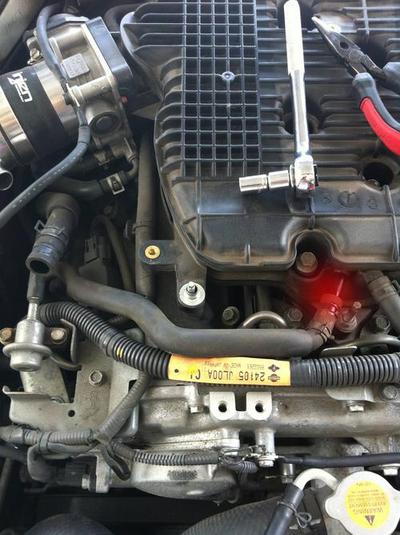

5. Push the throttle body back and start removing the ignition coil , do one spark plug at a time so that you don't mix up the wires. They are screwed down by a 8mm bolt and have ignition wire clips that also need to be removed before you can remove the ignition coil.

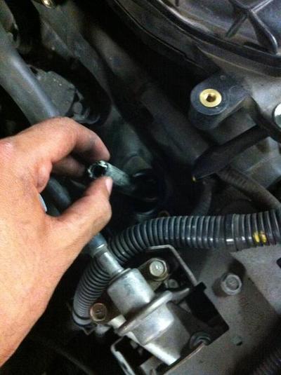

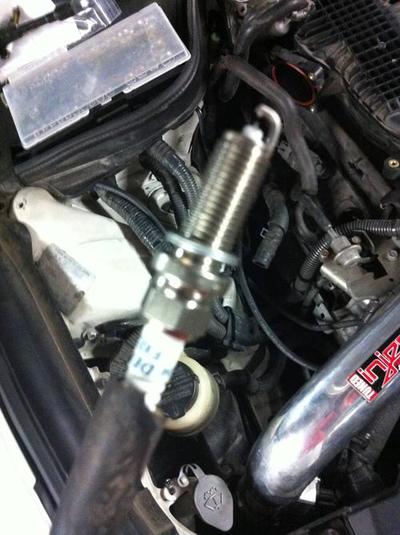

6. Take your spark plug remover tool or 14mm socket and remove the spark plugs, do them one at a time so you do not mix things up. Take your vacuum line and pull the spark plug out.
7. Take your new spark plug and put it into the spark plug removal tool or vacuum line and hand tighten it back in.

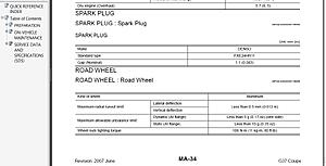

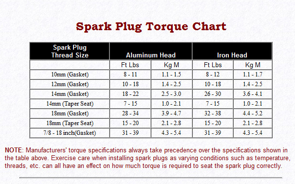

8. The new plugs will need to be torqued into place since they have a crush washer.
I looked around the FSM and could not find anything about torquing the plugs down, I did find this website that suggests torquing them down to 18-22 Ft Lbs(correct me if I'm wrong) -www.magers.org/handy/plug_torque.html
Follow steps 2-8 to complete the opposite side
The plugs are rated to run for 100,000 km (thats what the dealer told me)
If you wish to follow the FSM you can find this under MA(maintenance) on page 18

Torque is 14 ft-lbs. Found it on EM-16.
